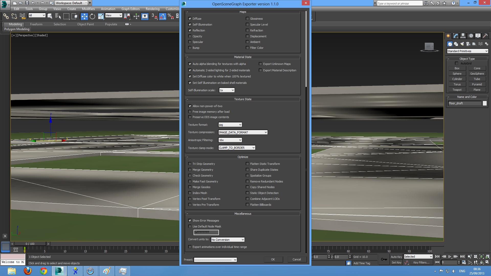

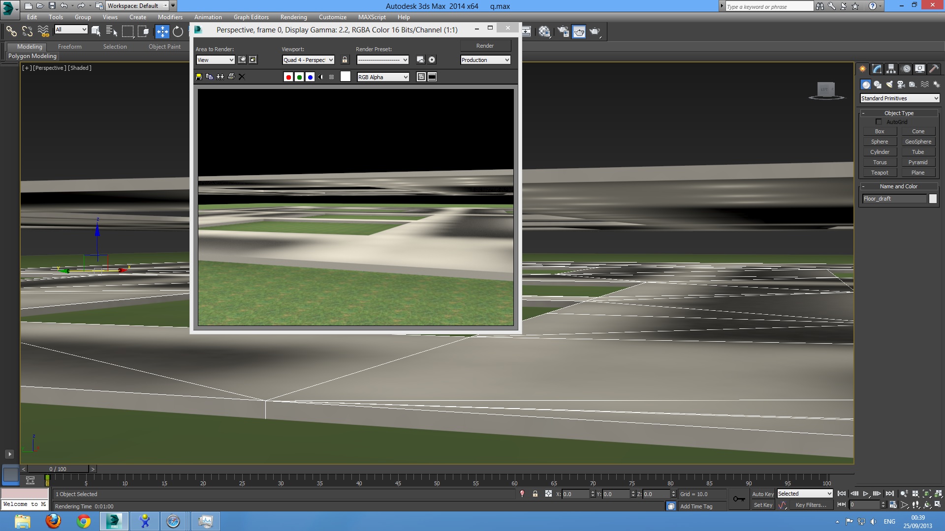

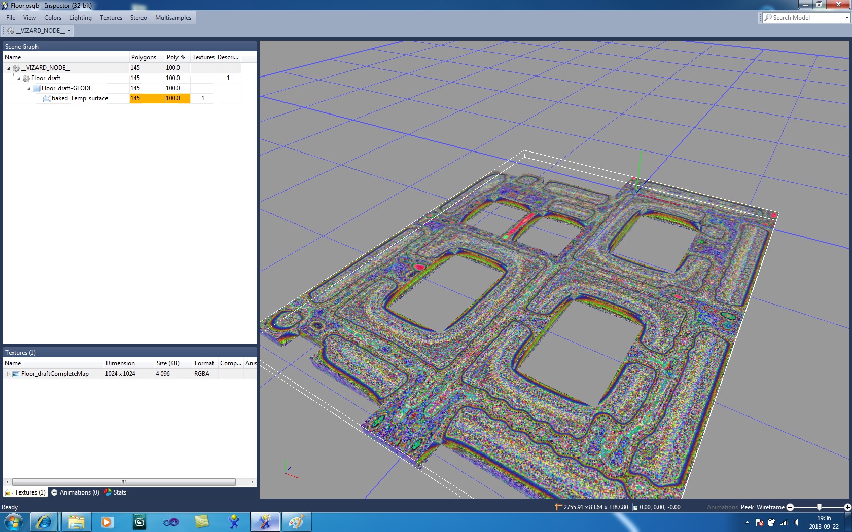

I have currently a problem with exporting my model into vizard from 3ds max. I have baked the lights and everything looking correct but when i export to vizard as osgb this happens. How i can fix it?

Old 09-23-2013, 11:18 AM
Can you attach images of your render to texture and osg export settings?

Here Jeff. Before I was exporting and model come out fine. When I lightmap it this happened ;/

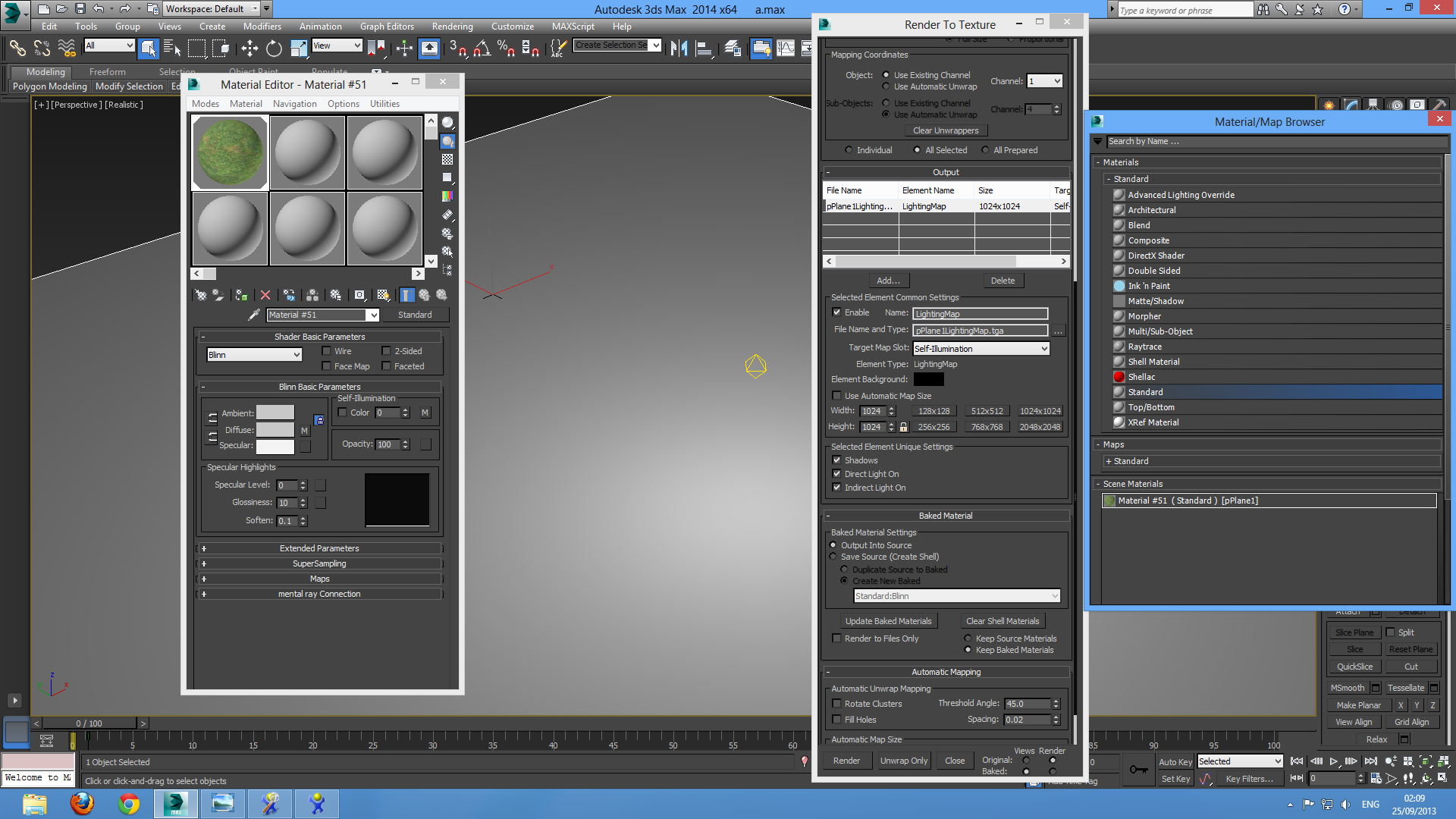

Old 09-25-2013, 09:44 AM
Can you also attach an image of the render to texture dialog box that shows all the settings used for the bake?

Here you go

Old 09-25-2013, 02:55 PM
Under Baked Material Settings try the Save Source -> Duplicate Source to Baked setting. The Light baking for Vizard tutorial shows our recommended settings.
