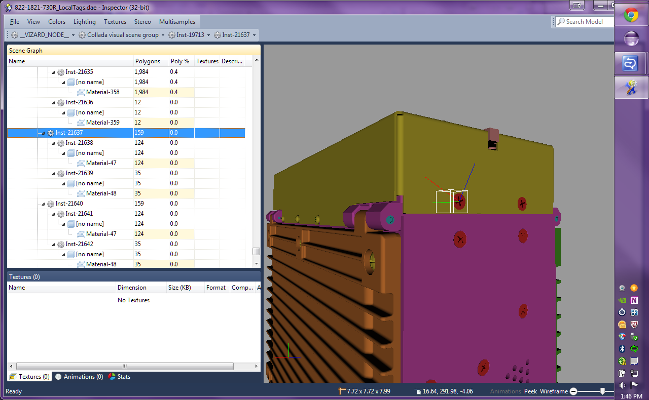

Axis Coordinates from Inspector
I am having a little trouble finding the axis relative to the global coordinate system of an object from within Vizard. When I get the handle for the object in question, and try to get the coordinates, I see that it should be perpendicular to the global axis.
screw.getAxisAngle(mode=viz.ABS_GLOBAL)
[-1.0, -0.0, 0.0, 90.0]
The information I am interested in finding is the angle of the straight line coordinate system relative to the global coordinate system as shown in the attached screenshot of inspector below. Is this the Normal angle of the object? It's obviously available in inspector, I'm just wracking my brain trying to figure out what it is in Vizard.

Old 08-31-2012, 04:34 PM
The axes in Inspector contains the accumulated transform of the selected node path. You can find the equivalent transform by calling:
xform = node.getMatrix(viz.ABS_GLOBAL,node='name')
Where name is the name of the selected node in Inspector for which you want to retrieve the axis transform from.
I just noticed that this command won't work if the name refers to a leaf (drawable) node. This will be fixed in the next release though.

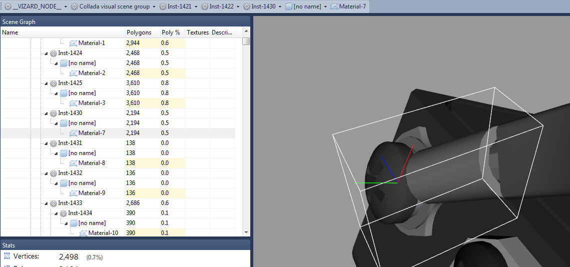

So to follow up, I've been able to reproduce the coordinate system in inspector. However, I am now trying to move that screw along one of the axis of that coordinate system by doing the following:
moveaction = vizact.moveTo(y_trans,time = 1.0, mode = viz.ABS_GLOBAL)
screw.addAction(moveaction)
The point y_trans refers to is the endpoint of the green axis in the attached photos. As you can see by the second photo, the screw does not get moved to the end of the green Axis. Is viz.ABS_GLOBAL the wrong mode to use with this command? Or am I just referring to the wrong coordinate system?
ID:	521   Click image for larger version

Old 09-07-2012, 11:56 AM
No, you will want to use the default viz.ABS_PARENT mode, since you want the screw to move along its local axes.
How are you getting a handle to the screw object in Vizard? Are you using the getChild command?

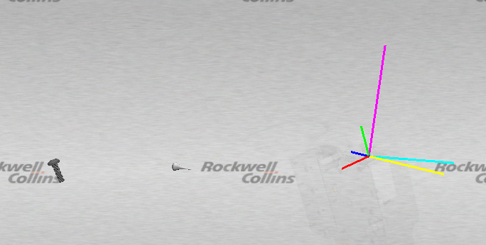

I'm not sure if it's clear on what I'm trying to do. The first attached picture contains two coordinate axis drawn on the screw. The first one replicates the coordinate system that is created in inspector with axis colored red, green and blue. The second coordinate system shares its origin with the first, but is drawn to represent the global x,y,z coordinate system.
The basis for the first coordinate system is from the matrix created from the command:
<node3d>.getMatrix(viz.ABS_GLOBAL, node='Inst-1430')
[ 0.000000, -0.004384, -0.008988, 0.000000,
  -0.000000, 0.008988, -0.004384, 0.000000,
  0.010000, 0.000000, 0.000000, 0.000000,
  -0.381762, -0.560596, -2.557960, 1.000000 ]
So the x-coordinate is drawn by creating a vector using the 4th and 1st row of this matrix and scaled (just so they are visible). And the y (elements 5-7 of the matrix) and z (elements 9-11 of the matrix) coordinates are created using a similar method.
[-0.381762 + 0.0,  -0.560596 + (-0.004384), -2.557960 + (-0.008988)]
So the point I used to create the y coordinate is called y_trans.
I made the assumption that using the command
moveaction = vizact.moveTo(y_trans, mode = viz.ABS_GLOBAL)
<node3d>.addAction(moveaction)
Would move the screw to the endpoint of the green axis. Instead, that command moves the screw to the position shown in the second attachment. Is this because the transformation matrix given by the getMatrix command is applied to the node before the translation of the moveTo command?
Here is the complete code I am using to draw those axis:

Old 09-11-2012, 10:11 AM
There is not enough information for me to say what the problem is. My guess is you are applying the transformation at the wrong hierarchy in the scene. node.getChildren will not return anything unless you previously called node.getChild or parented a node to the object. So it's not clear to me exactly which node you are operating on.
Click on the screw you want to translate in Inspector, then post a screenshot of the node path bar at the top, showing the full hierarchy of the screw. This should provide me with enough information to post some sample code for you.

Old 09-11-2012, 12:49 PM
Thanks. The following code should translate the screw object along its local Y-axis:
screw = model.insertGroupBelow('Inst-1430')
screw.setPosition([0,0.1,0])
This works by inserting a node below the Inst-1430 node. If you had called getChild on the node, it would have inserted a transform above the node, which would then translate the node in the incorrect reference frame.
Make sure you only call insertGroupBelow once per sub-node, since each call will insert a new node.
