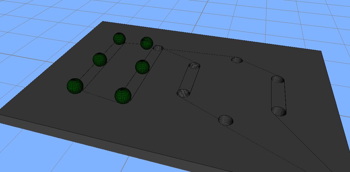

Here's another example to demonstrate my question:
If I have a ball sitting atop a hole which is slightly smaller than the diameter of the ball, and gravity or a force is enabled, my ball doesn't "sit still" atop the hole. Rather, it wobbles around the hole for several seconds until it eventually slows down and sits atop the hole. If the collision plane and ball is perpendicular to gravity, shouldn't the ball's position remain initially constant and not wobble around?
My attached pictures shows one of the balls wobbling around the hole instead of its position remaining constant.

If modifying the physics properties of the object is not working the way you expect, you could try removing all forces on the ball once it reaches a certain position. To do that, use the node3d.reset command.
Old 11-02-2012, 02:44 PM
mhead10 mhead10 is offline
Join Date: Mar 2012
Posts: 40
Jeff, thanks for your reply.
I think I found the problem (for the 2nd example) was because the ball's center was at (0,0,0) and the position was initially (0,0,0) as well. Therefore, the ball was initially colliding with the ground and thus it pops or bounces up.
If I moved the initial position to (0,.25,0), then I didn't notice a bounce.
Thanks again!
