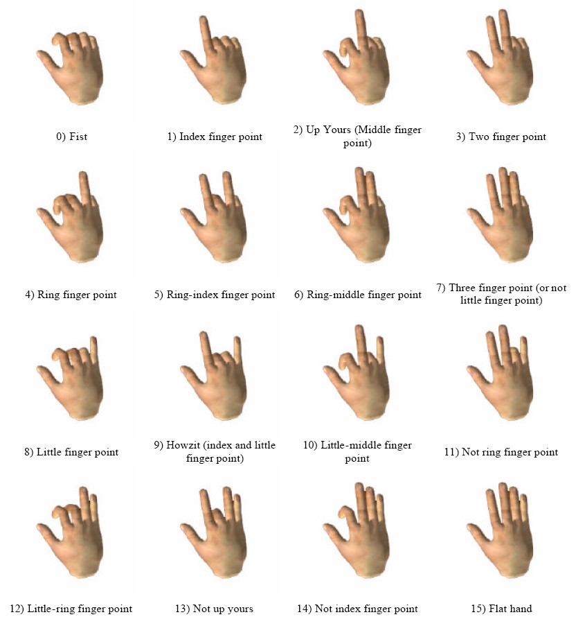

Hi, All
Is there a description of gesture methods to work with 5DT Data Glove 5 Ultra?
Thanks in advance,
Andrey
Old 11-30-2007, 02:42 PM
The attached image shows all the gestures recognized by the 5dt data glove. The following constants are defined in the hand module and represent each respective gesture:
GESTURE_FIST					= 0
GESTURE_INDEX_FINGER			= 1
GESTURE_MIDDLE_FINGER			= 2
GESTURE_TWO_FINGER				= 3
GESTURE_RING_FINGER				= 4
GESTURE_RING_INDEX_FINGER		= 5
GESTURE_RING_MIDDLE_FINGER		= 6
GESTURE_THREE_FINGER			= 7
GESTURE_LITTLE_FINGER			= 8
GESTURE_INDEX_LITTLE_FINGER		= 9
GESTURE_LITTLE_MIDDLE_FINGER	= 10
GESTURE_NOT_RING_FINGER			= 11
GESTURE_LITTLE_RING_FINGER		= 12
GESTURE_NOT_MIDDLE_FINGER		= 13
GESTURE_NOT_INDEX_FINGER		= 14
GESTURE_FLAT_HAND				= 15
