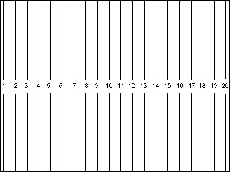

I'm suspecting that there's a problem with our Fakespace Labs' HMD: it seems to not display enough of the peripheral area. I created a simple 1600 x 1200 px. image (1600 x 1200 is the HMD's max resolution) to test it out:
Now in Vizard this "magic" line of code splits the output into 4 images so that when viewed on the HMD one can take advantage of the wide view angle:
import fakespace
fakespace.wide5(ipd = 0.06, yaw = 11.25, pitchN = 10.0, pitchW = 5.0)
I was wondering if there is a way to load the image above into Vizard or something to really be sure there's a problem with our HMD (i.e., only lines 3-17 will be visible)? If there a way to do this without Vizard that will do too.

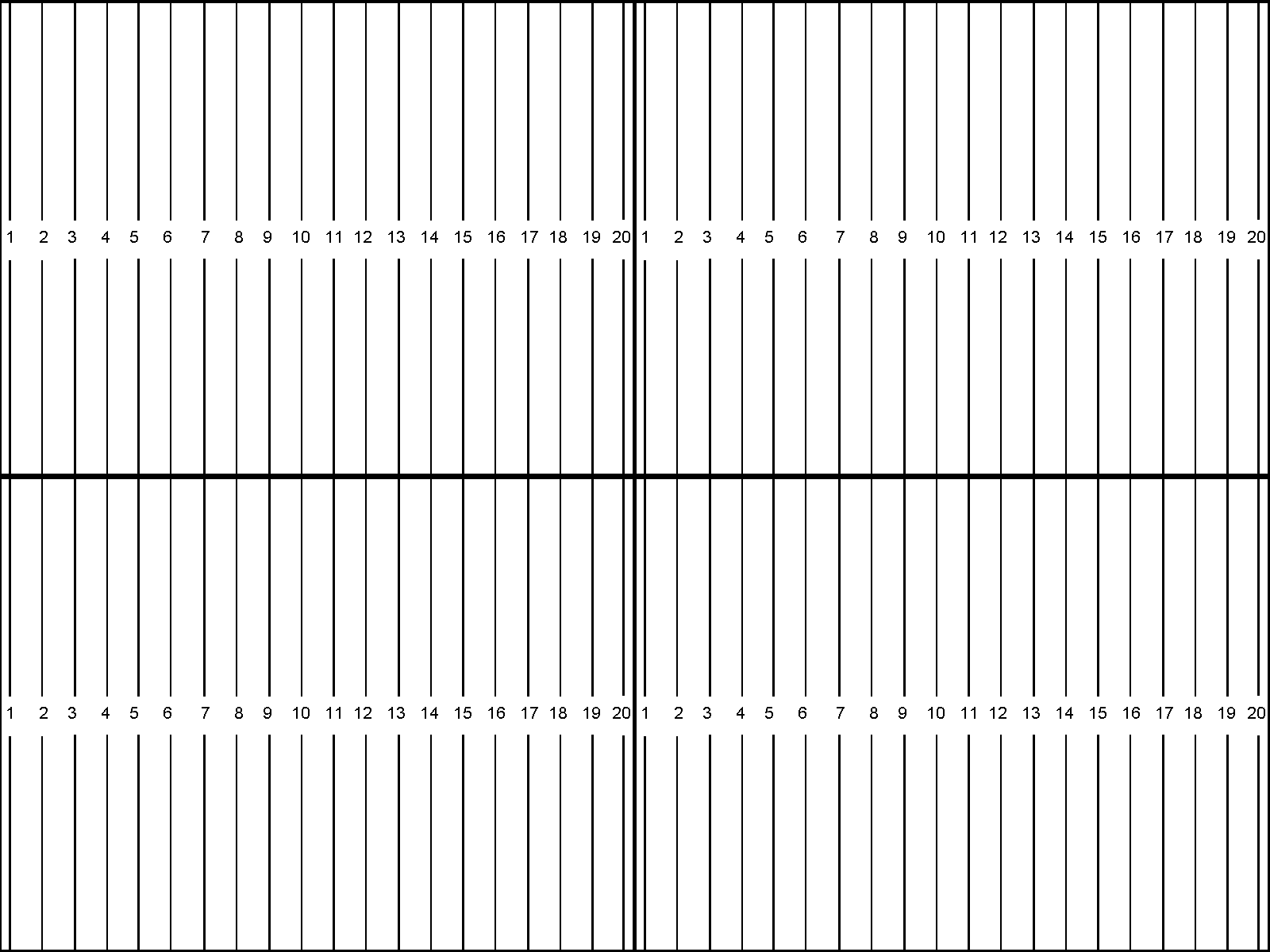

I just tested out that piece of code.. Well, when using this 800 x 600 image:
What appears on the monitor screen looks like this:
(Vizard notifies us that it's "Scaling image 'hmdTest1.bmp' from (800,600) to (1024,512)")

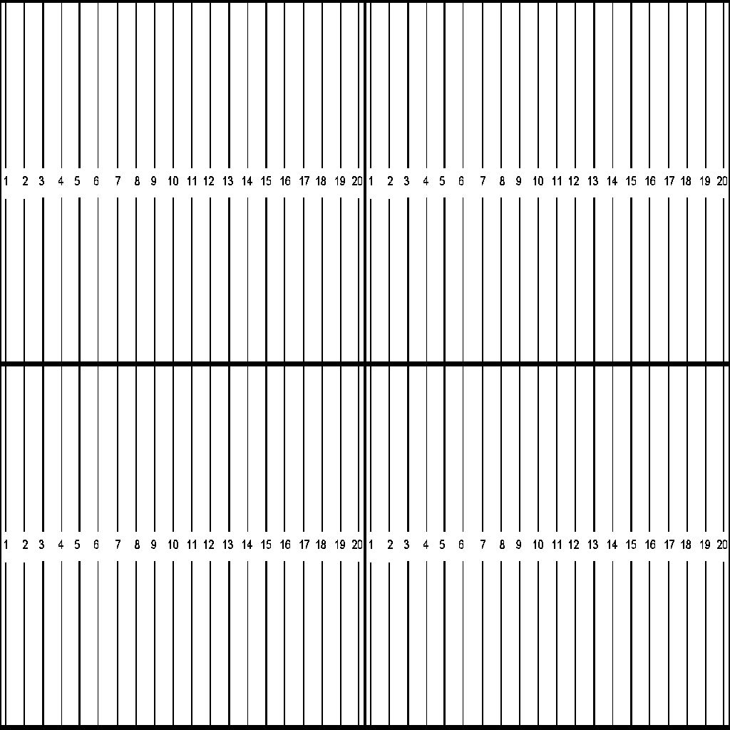

With this 1600 x 1200 image:
The output on the monitor screen looks almost the same as in the previous case (three quarters of the screen are blank):
Again, Vizard says that it's "Scaling image 'hmdTest2.bmp' from (1600,1200) to (2048,1024)")
In both cases the HMD itself shows garbage: no lines, a mess of white and black dots instead.

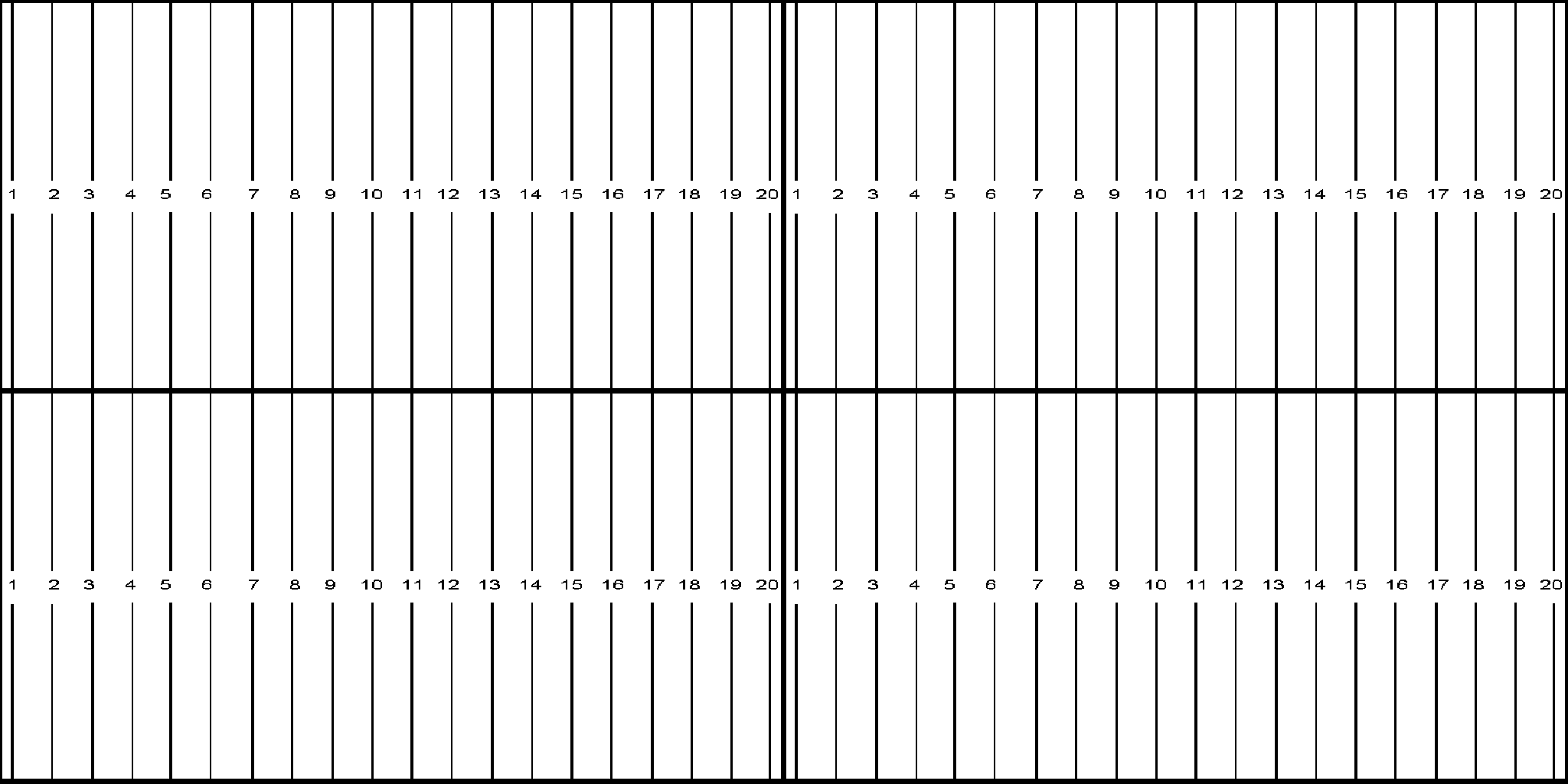

Thanks farshizzo, I get it now. Your code works although the image is still definitely "shifted" in the same way as before (see thumbnail below). One thing I do not understand is why this shift is present now when I don't even set up the HMD's yaw/pitch offsets? How can I center the image properly?
Old 05-22-2008, 03:40 PM
The code I posted will display the entire image on the screen. If you ran the exact code I posted and it doesn't work, then there might be an issue with your graphics card or driver. Are you using the correct drivers for your card?

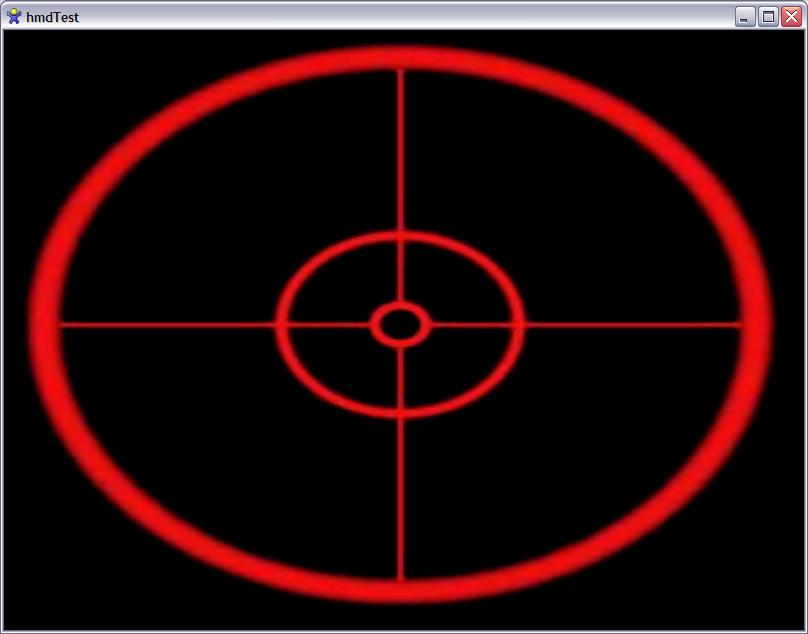

Well, that rules out the HMD. Can you try using the texture crosshair.png with the above sample code? Does the crosshair fill up the screen? Your entire script should look like this:
quad = viz.addTexQuad(parent=viz.ORTHO)
quad.alignment(viz.TEXT_LEFT_BOTTOM)
viz.link(viz.WindowSize,quad,mask=viz.LINK_SCALE)
texture = viz.add('crosshair.png')
quad.texture(texture)
And the output should look like the attached image.

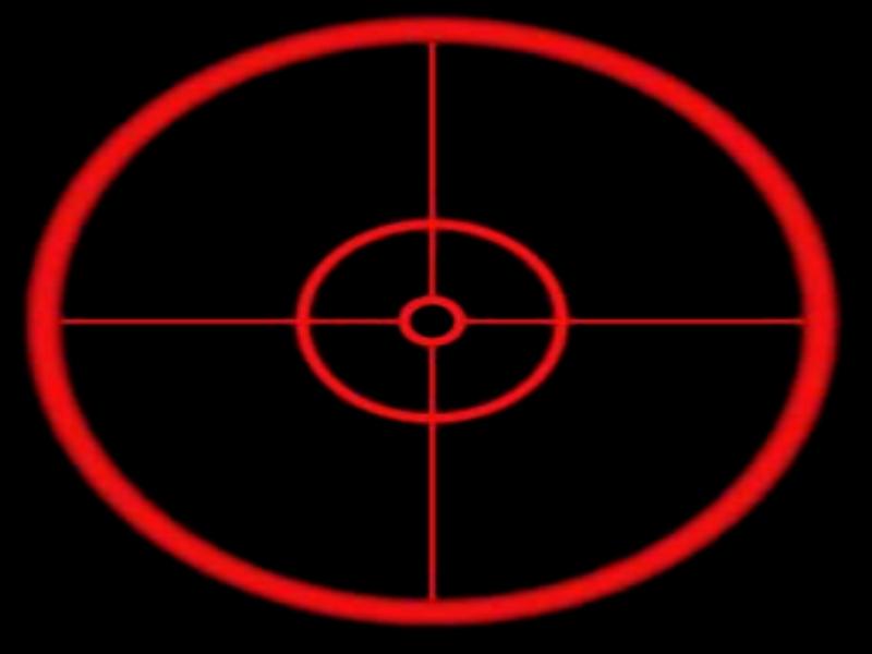

Yeah, this works, although the crosshair doesn't fill up the whole screen, it's shown in a window like this (see attached image).
Don't you have to use
viz.go(viz.FULLSCREEN)
instead to get the full-screen output? When I do that the image is shown full-screen properly.
