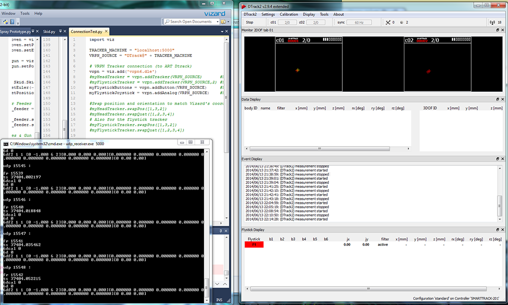

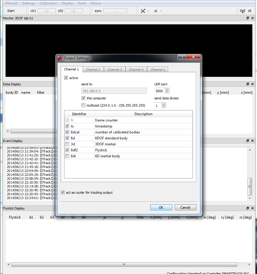

Well, at this point I'm probably doing something incredibly basic and wrong.
Removed all firewalls.
I have the software running and I ran a utility that allows me to receive the output (first image attached).
I've tried searching online and reading though the documentation, lots of mentions about DTrack and ART and VRPN but no direct explanation of having the two interact... and unfortunately much like Lady Gaga, I don't speak German.
Is there some form of middlewear I am missing to have this application output the data to VRPN format? I am running everything off a different computer this time (switched to Windows 7 from 8.1)

Solution to the problem for future interested parties:
1) Setup output in DTrack2 for the flystick or any other device you plan on using.
2) Setup the VRPN server. You can either download the windows binaries online or by registering your SmartTrack with A.R.T. they will provide a download location.
3) Edit the VRPN config file by searching for DTrack. You'll want to uncomment the following line:
vrpn_Tracker_DTrack DTrack 5000
4) Start your DTrack2 and press the start button to begin tracking and trasmitting.
5) Start your VRPN Server
6) Connect to the VRPN Server using WorldViz Vizard at the following:
device_label = "DTrack@"
vrpn_source = device_label +  ip_address
vrpn = viz.add('vrpn7.dle')
tracker = 	vrpn.addTracker( vrpn_source )
buttons = 	vrpn.addButton(  vrpn_source )
joystick = vrpn.addAnalog(  vrpn_source )
7) Your VRPN server should have spit out some command line notification about Vizard connecting and eventually disconnecting.
