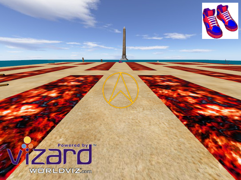

Hello all
I create sky using the following lines
env = viz.addEnvironmentMap('sky.jpg')
sky = viz.addCustomNode('skydome.dlc')
sky.texture(env)
The problem is in some angles the sky is not covering the horizon. Here I have attached three screen shots showing the situation. When you go forward it covers more. It is like this for only some angles. When you turn back it covers the whole horizon. Would you please let me know how to solve it? Thanks.
