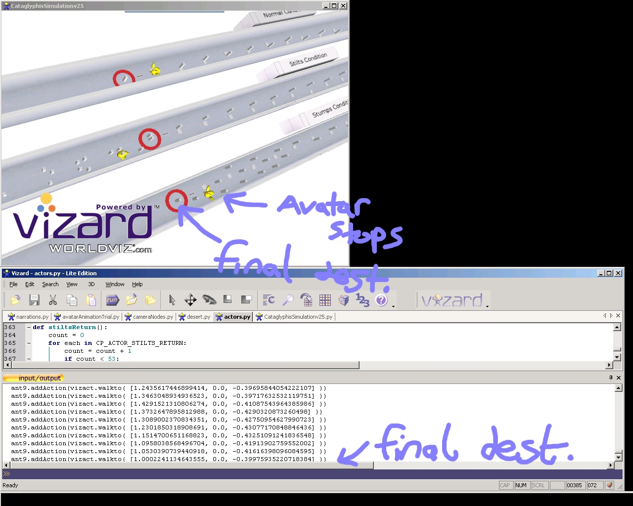

Unhappy walkTo ... does not reach final destination....
I used for loops to read geometries that define the walkTo's coordinates.
Vizard read them okay. Please see the terminal window. However, Vizard did not finish the movement properly. The ducks are 1 coordinate behind the final destinations.
I did try to type in the last command to force the duck to go to the final destination, but it didn't do anything.
The coordinates are all in order, I did not missed a single one.
Could someone point out where did I (possibly) go wrong?

Old 05-02-2008, 05:03 PM
Can you post a sample script that reproduces the problem? It's difficult to tell what the problem is by looking at the screenshot.

Red face Action sequence code.....
Here is the module that load the objects file and set-up the movements...

During action, ant 7,8 don't go to the final box, but ant 9 hit the final destination. During return sequence, ant 7, 8, 9 don't go to the final destination.
Any ideas, or insight would be appreciated. Thank you.

Old 05-05-2008, 06:43 PM
I ran your script but nothing is happening. Your script loads the path points from a file called 'antMovementPoints.osg', which was not included. Can you post this file, or modify your script so that it does not depend on it?

Old 05-08-2008, 03:23 PM
Your sample script still does not do anything. Can you post a fully working script that I can immediately run and witness the problem. For example, there is no viz.go() statement in your script. Even when I added the viz.go() the ducks never start any actions and I don't see any key commands to initiate them.

Red face Solved~!
I do apologise for making you running around in a circle. I did not explain the script fully. I tried to post the full code, but this forum refused it, being too lengthy. What I posted previously was a module of a bigger simulation program. You need to add viz.go() as well at the end of the program.
I do apologise.... T_T
You may use these following these commands (in the terminal window) to make them run...
controlAction()
stiltsAction(), and
stumpsAction()
..to make them run.
I just found the solution. I increased the spacing between the movement points and it works just fine. Apparently, my spacing between points were too small. I Increased the spacing and it works really well.
Thank you.
