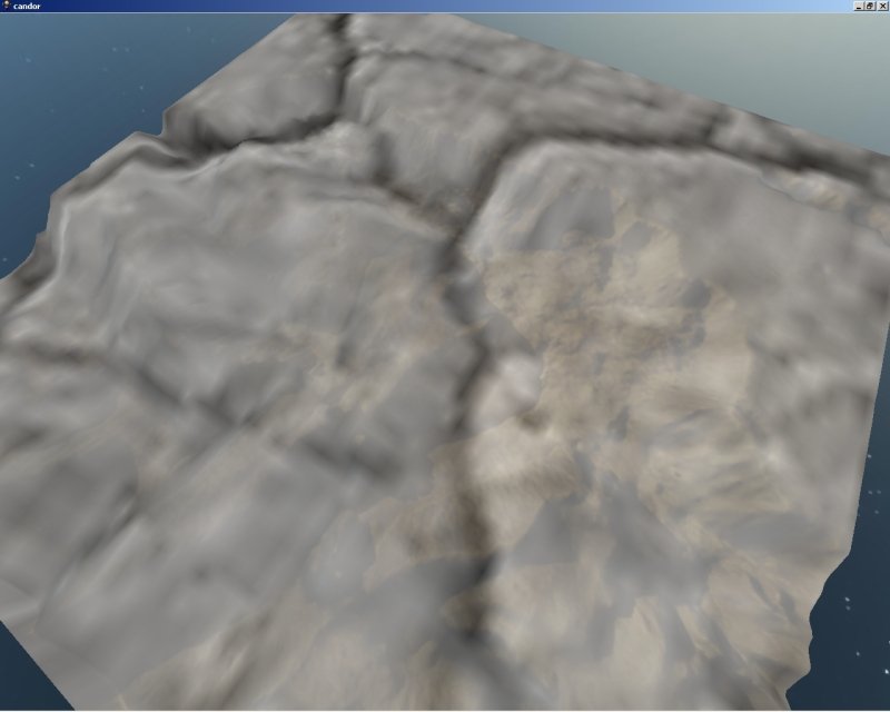

Firstly, thanks for the reply. In order to attempt this blend-multi texture, I created a model out of Candor Canyon on mars, and I textured it.
The blending does work, but the repeating texture does not. for the detail texture I used a 64 x 64 image. I was hoping this small texture would repeat itself over large terrain.
There are 2 screenshot attached;
no_detail.jpg - plain texture.. no additional texture applied
not_tiled.jpg - I could see here that my 64 x 64 texture is fully streched across the terrain.
the terrain has only 1 UV map applied to it.
I attached my script, I couldn't figure out what did I do wrong??? could you have aa look and see why I couldn't repeat my small texture across the terrain?

Old 09-06-2006, 05:44 PM
The texture coordinates were probably not exported for the second texture unit. Try setting the texture matrix like I mentioned in my previous post.
m = viz.Transform.scale(20,20,1) #Repeat 20 times in both directions
stage.texmat(m,'',1)
Let me know if this works.

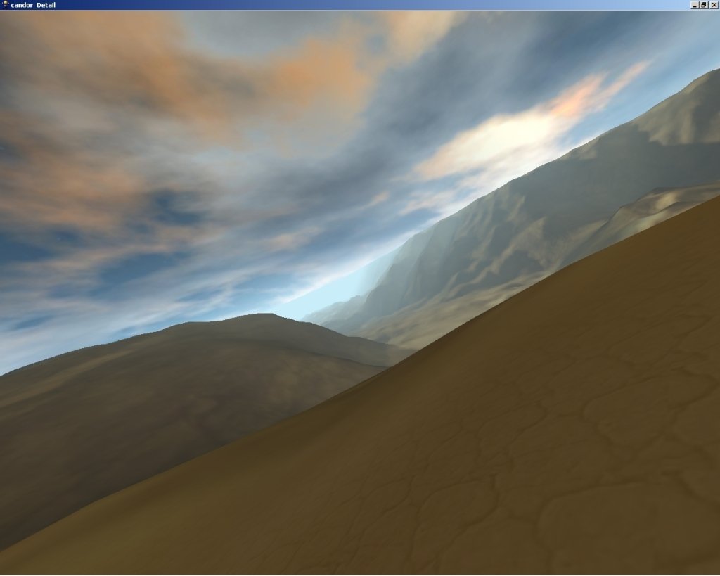

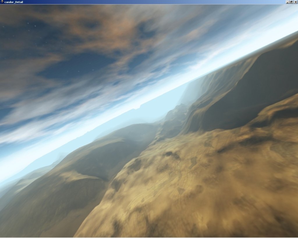

Thank you for your speedy response. It didn't work initially because I missed 2 lines!!! Thanks for pointing this one out to me.
Please look at the screenshots attached, the detail looks great. Detail texture may look bit repetitive for now, but it will change soon!
I attached my script with some changes in it, I had to bring the blend value to 0.065 to get the result that I wanted.

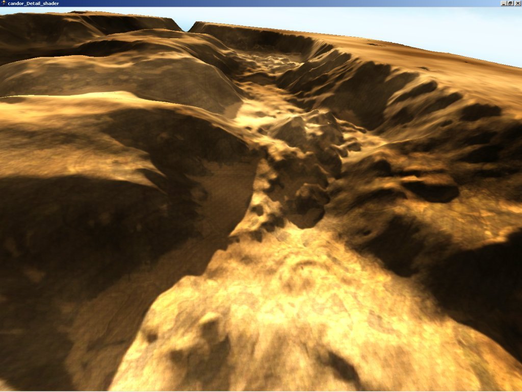

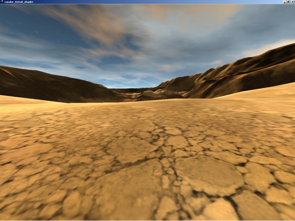

It works! Have a look at the screenshots attached. The fog is completely gone?!? and the terrain is somehow very-brightly lit!! (perhaps this is caused by uniform intensity command?)In which actually looks nice, I could turn down the spot light color a bit to get the brownish feeling on the planet.
I like the result! heaps better than normal blending. Thank you!
From high elevation the terrain looks bit funny with tiled detail texture (oh well). From right above the ground... the terrain looks amazing!! What do you think?

I agree, the close-up shot looks really cool! But the tiling is noticeable from far away. The second example you posted would fix the tiling problem, but it might be harder to create the textures for it.
The fog is gone because you are using a shader. You will have to implement the fog in the shader. Let me know if you need help with this.
The terrain is bright because of the scale applied. In the shader try changing the scale parameter from 2.0 to 1.0. If you end up doing this, then you don't even need the shader anymore, plus the fog will work again.
Either way, I just added the ability to set all the texture combine properties from within Vizard. This should be available in the next release.

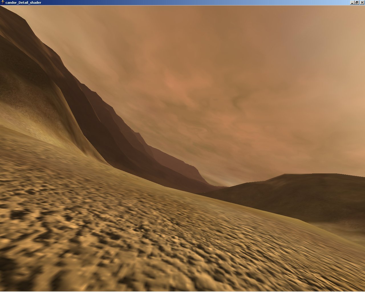

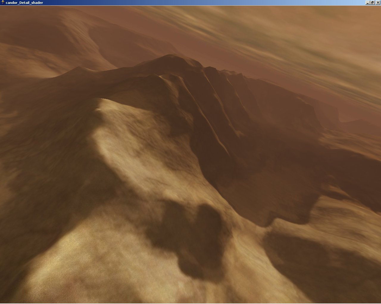

In order to reduce the intensity of texture on terrain, I decreased the brightness of the detail texture, without modifying the shader at all.
Also, a "proper" seamless texture for detail, decreases the ugly looking tiles on terrain greatly.
The fog definitely gives more depth to the scene. I attached the latest screenshots of your shader implementation The scene looks really nice!
