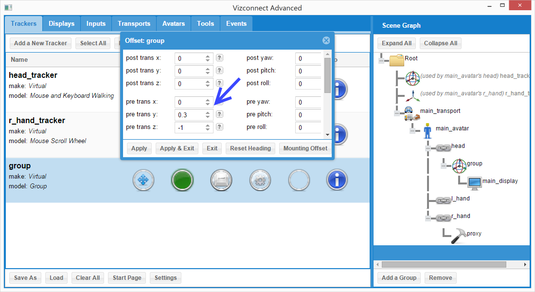

Try adding a group tracker and placing that between the avatar head slot and the display in the vizconnect scenegraph. Then open up the offsets dialog for the group tracker and apply preTrans Y and Z offsets to move the display above and behind the avatar:

Yes i did the same thing as u have replied,but was missing due to some offsets values for group tracker and now it works like a charm.

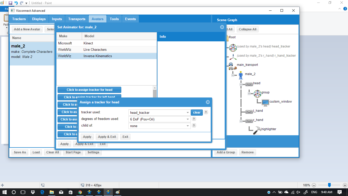

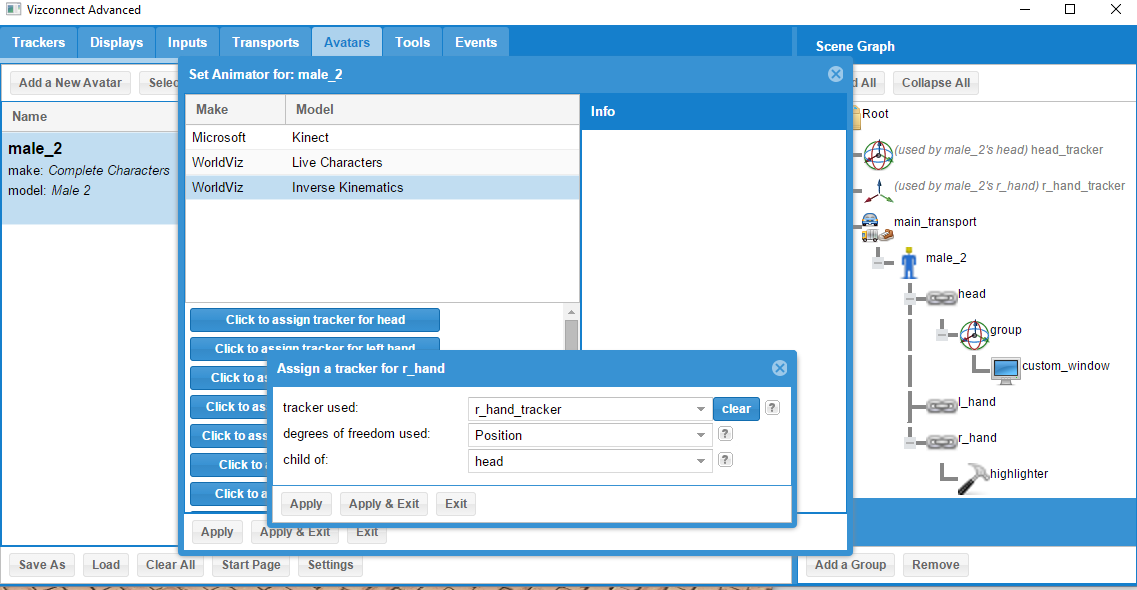

Do you have trackers assigned to the avatar's animator?
Old 07-30-2017, 11:07 PM
rajnishv rajnishv is offline
Posts: 94
Thanx for the reply Jeff,
PFA of the screenshot of head and hand trackers.
Also find the attachment of the main python script and the vizconnect file for reference.
Will wait for ur reply.
