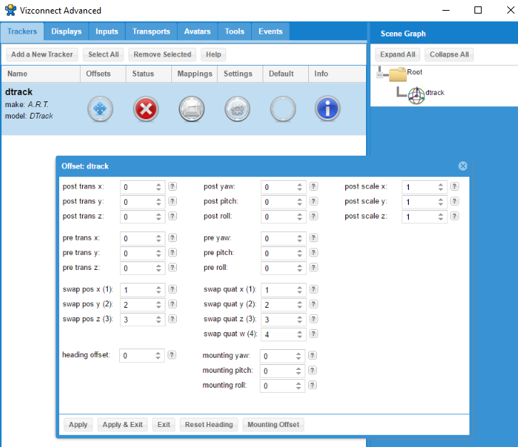

I have the ART SmartTrack working in the Christie HoloStation CAVE but when you put the tracked 3D glasses on it doesn't look like the correct view point for the user. It looks like the users eye point should be set to be higher. So I thought maybe the offset needs to be changed.
Since I was not able to use Vizconnect to setup the tracker is there a way to change the offset like you can in Vizconnect for the tracker (I attached the image that shows how you change settings in Vizconnect, but I didn't see information on how to do if not using Vizconnect to setup Tracker)?

Unless the ART origin is offset from the ground then it should not be necessary to apply a height offset to the tracker. You can add position offsets by creating a tracker link and applying the offset to the link. For example:
# VRPN Tracker connection (to ART Dtrack)
vrpn = viz.add('vrpn7.dle')
headtracker = vrpn.addTracker('DTrack@localhost')           #Default sensor is 0. Head tracker is on DTrack sensor 0
headtracker.swapPos([1,2,-3])
headtracker.swapQuat([-1,-2,3,4])
headTrackerLink = viz.link(headtracker,viz.NullLinkable)
# Adjust for origin offset from ground
headTrackerLink.postTrans([0,1,0])
