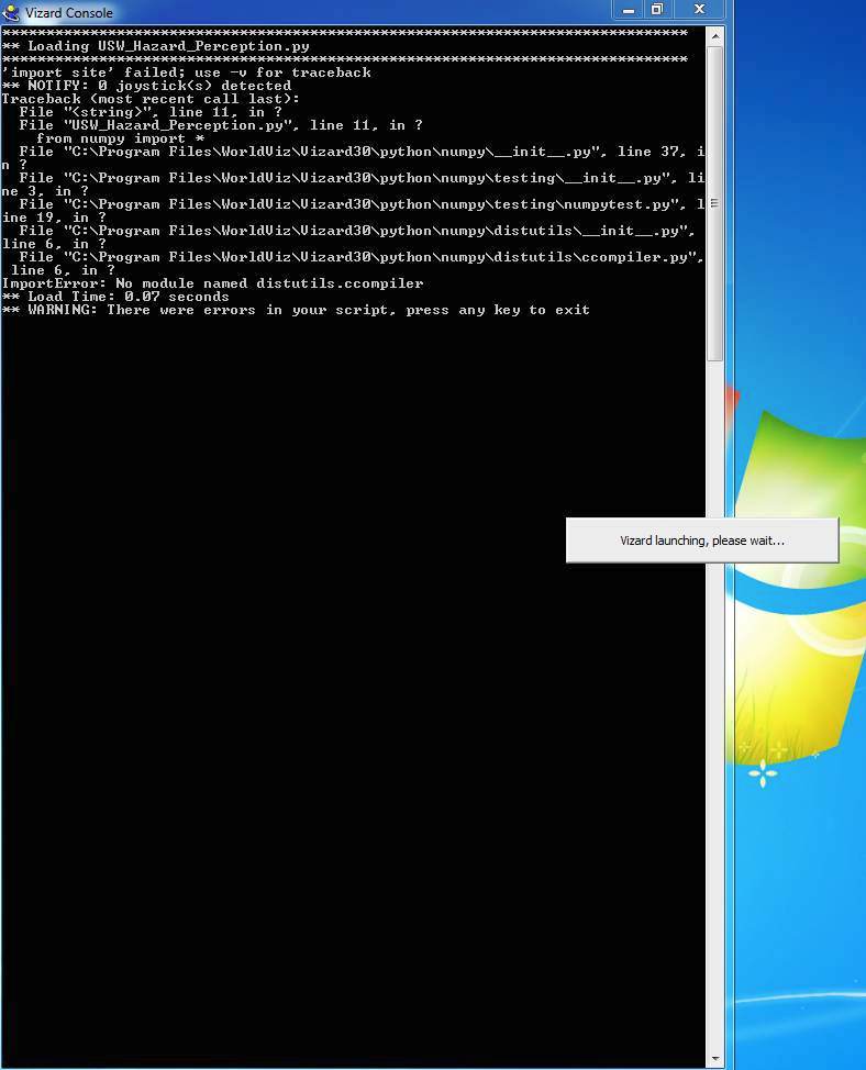

I have the run code with the console visible and attach the error that I'm getting. I have numpy installed on the PC that I'm creating the exe file on and the exe file works on this PC but as soon as I try and run the exe file on any other machine that doesn't have numpy installed, I get the attached error message.

If a file is not automatically included in the executable you can manually add it in the second step of the publish wizard.

Thanks Jeff, I think I knew that somewhere in the depths if my memory from a similar issue a few years ago.
Unfortunately, in this instance adding the missing files hasn't worked.

It's best to trigger the code using numpy while compiling the executable. Then, the files that Vizard needs to run the executable will be compiled in the executable. You can also add files manually, but chances are you're missing out on one or two 'obscure' files (a .dll file).

I have tried everything, including adding the missing files and the executable still isn't working, although the error in the console has now changed to the attached.
Any other thoughts??

I tried publishing a simply numpy example with Vizard and it worked fine. Can you reduce your code to the smallest example possible that reproduces the issue when published? Perhaps reduce it to some numpy code or even import statements related to that library and then post that here.
