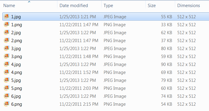

Attached are the image, they all look good to me.

I just tried your sample images and they loaded fine. They are 100x100 though, but that might just be the forum resizing the images. The error message you are getting should only occur if the image your are loading does not match the 3D image width/height dimension, or if the pixel formats differ.
Old 01-25-2013, 03:43 PM
Join Date: Feb 2006
Location: New Jersey
Posts: 182
That is the forum resizing the images.
They all check out to be 512x512 inside Photoshop...
Old 01-25-2013, 03:53 PM
Join Date: Feb 2006
Posts: 182
I just tried downloading the forum images and I get back the 512x512 for some reason... However I tried changing the last one to half the size to see what error I get... and it isn't a dimension error I seem to be getting on the other images.
