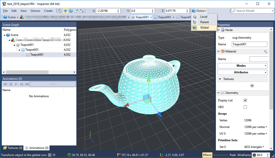

In addition to that, check your coordinate space. (see attached)
