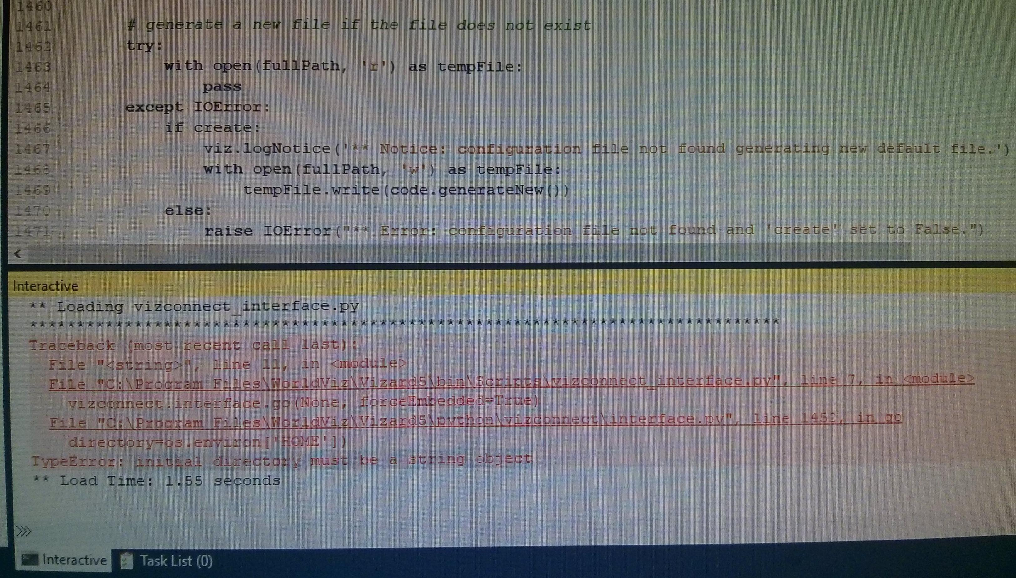

I have just installed Vizard 5 free 64 bit on a new computer with Windows 10 pro, and when I lunch Vizconnect from the Tools for settings, I get the error in the picture: how can I fix it?

Try reinstalling Vizard and let us know if that fixes the error. You can run the Vizard installer again and you'll be prompted to uninstall what's currently there.

I've already tried it without results.
Old 05-18-2017, 08:26 AM
Do you also get an error if you run the following code on it's own?
import os
print os.environ["HOME"]

Thanks! I've solved renaming the user of the computer and so the path.
