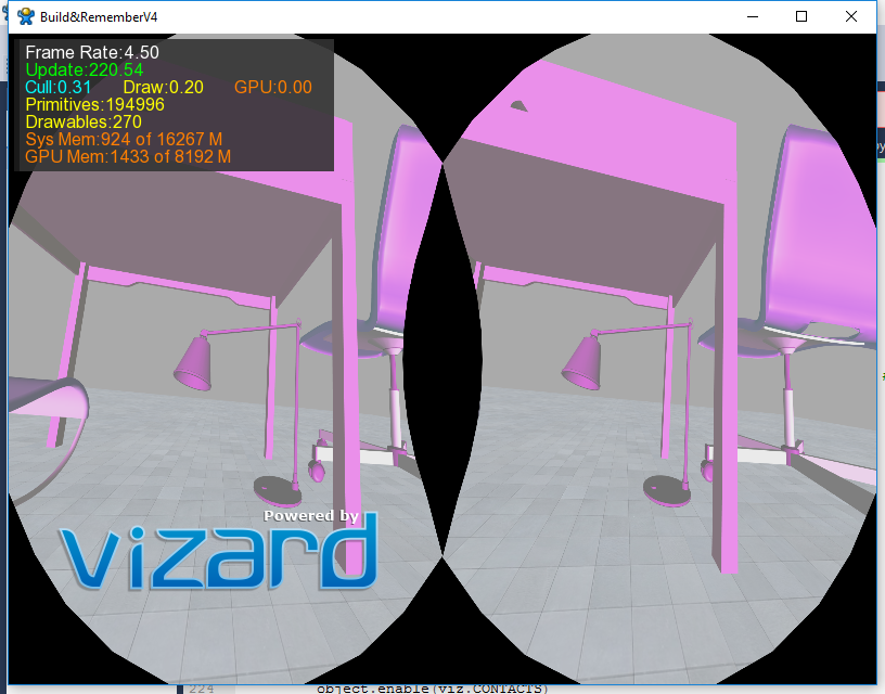

Can you attach a screenshot that shows the render stats when the models are close together and the framerate drops?

Yes, of course!
It seems I found the main reason for the frame drop: its the collideMesh() I am adding to the models.
I attached 2 images, showing the render stats for 2 versions of the same environment, once with and once without collideMesh() for each model.
Would be great if there is a way I could still be able to grab, move, and overlap this limited amount of objects.

Can you explain the reason for using the collide mesh? Do you need to have physics enabled for grabbing and placing objects?

You are right, I rewrote it so that I use the Grabber and that solved it!
I didn't use it from the start, as the experience was a bit limiting with larger objects due to measuring the distance to the objects center when grabbing.
But in this thread you provided a solution for this and now it works well!
Would be great if setting bounding box vs. object center would be an argument in the standard grabber tool!
