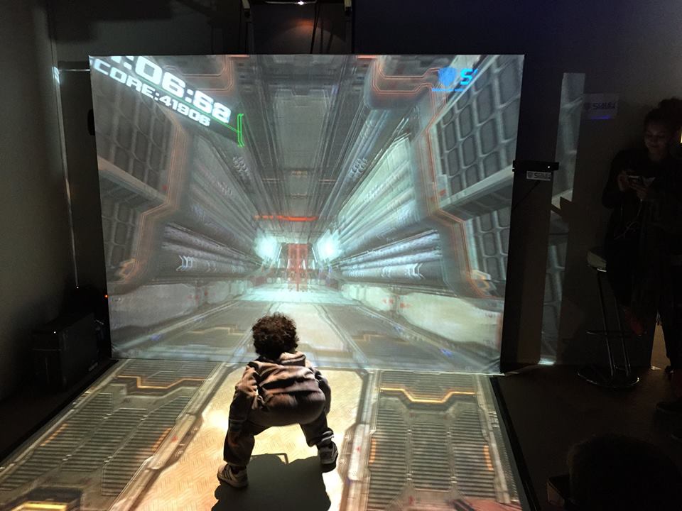

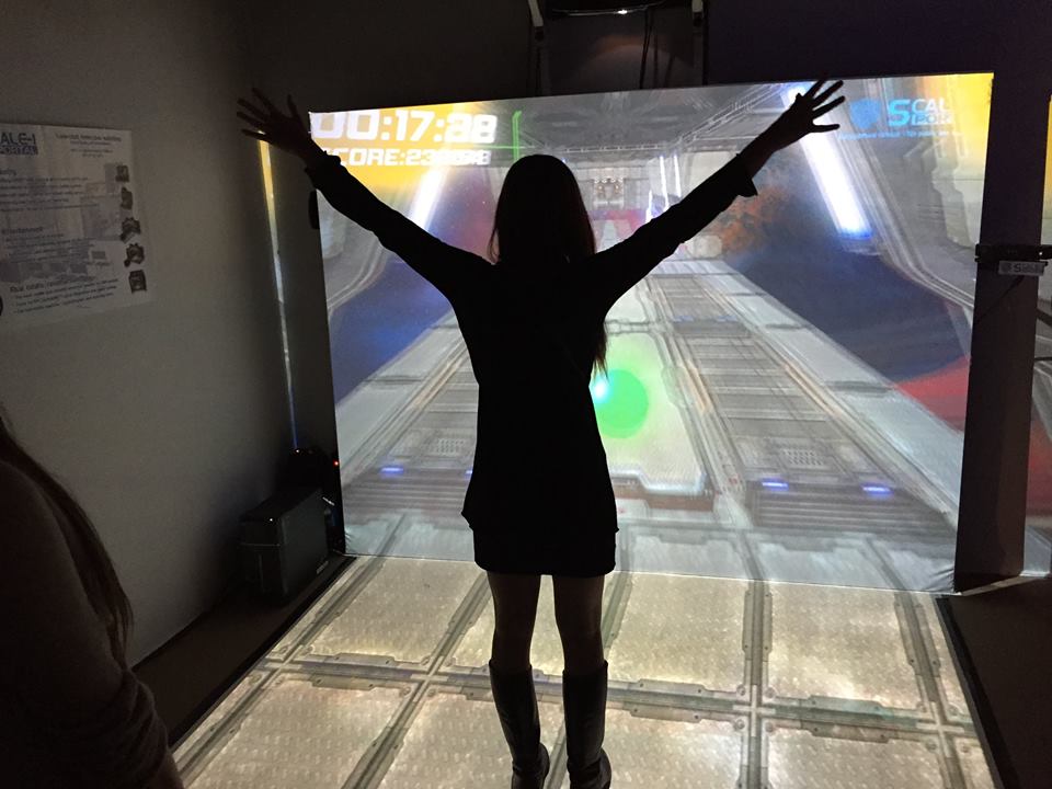

I am developing a demo with Vizard 5,for a client who needs only front wall and floor wall(half way).
I ahve extended the display on front and ground,but unable to get the real immersive ness what i want for thsi kind of projection(front and floor).
I need to configure the demo in such a way that its gives me actual perpective on projection to front wall and floor wall(Half way).
Is there any display mode ,which i can select from Vizconnect GUI,to get such a projection perpective,which give real feel on the floor mainly with relative to front.
I am attaching some images for reference.Pls see to it jeff.

If you have an Enterprise license(s) you could use the 'Cave Manual Configuration' option in vizconnect and select front wall and floor. In the 'side image width' field enter the floor depth value.
If you're using a Development license this can be done through vizcave code directly. See the vizcave single machine example. However, there is no built-in vizconnect option available, it would require manual changes to the vizconnect code.
