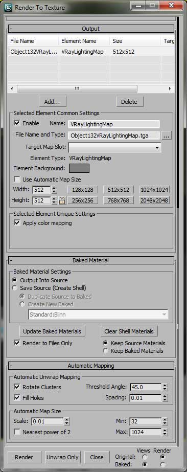

I have created a scene in 3dsmax that uses vray to produce the lighting. I was wondering how I go about baking lightmap using vray?
When I follow the wiki lightmap tutorial, max crashes! Both 32 and 64 bit version.

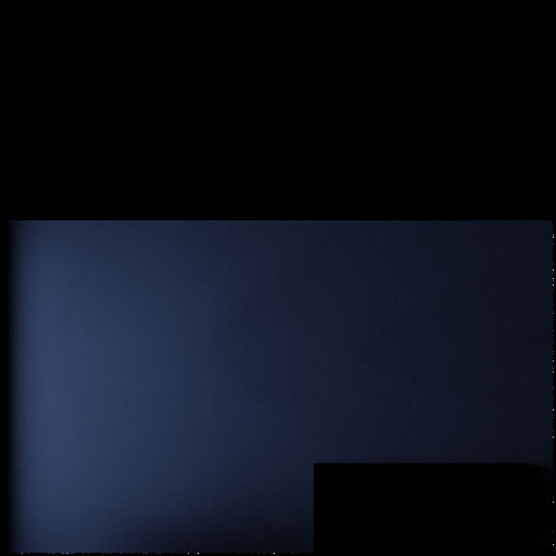

When I tried to render a lightmap using VrayLightingMap element in the baking dropdown menu. (See screenshot)
It did render successfully, but it appeared to render something that resembles a complete map! (See screenshot)
When I created a standard material, with a diffuse and lightmap (both rendered using steps above) it created a model with a dark texture that wasn't the same when I rendered in viewport. (I have also attached this OSGB file)
Is there a process that was followed to render lightmap in vray for the dojo/piazza in Viz4?
Thanks!
David

Old 10-26-2011, 11:44 AM
Hi davidrichens,
Baking VRayLightmaps is incompatable with Standard materials, and will produce something like a CompleteMap as you said. Ideally you should only be using VRayMtl materials.
If that would be too time consuming, the quick and dirty way is to to go to Render Settings, VRay Tab, VRay Global Switches rollout, then add a 50% gray VRayMtl in the material override slot. After that, click on exclude and exclude any transparent objects from override. This will keep windows and similar objects from going opaque during the bake.
Any object affected by the override will be able to produce proper light maps. The main drawback of this method is that it reduces the accuracy of the GI solution by removing any variation that comes from surface color. EG. light bounced off a bright red wall would become red and add a slight red tint to any nearby surfaces.
