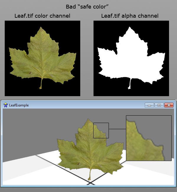

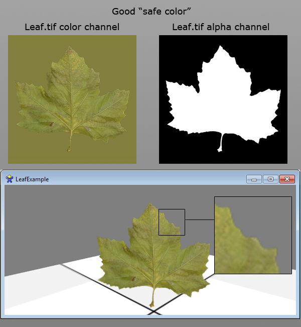

Old 09-26-2011, 04:02 PM
I've attached a couple example images that should give you an idea about what's going on.
ID:	443   Click image for larger version
