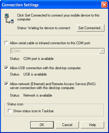

Because of the instalation of Measurand software, Microsoft ActiveSync is bocking the COM port. To stop ActiveSync from blocking the COM port open ActiveSync and select File->Connection Settings. From this uncheck the "Allow serial cable or infrared connection to this COM port:" box.
This should clear the COM port for use by Intersense.
Paul E
