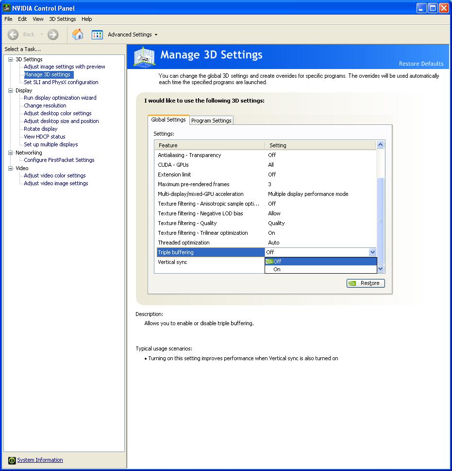

However, there was one more issue came up. When the VR scene was updating (i.e. when I rotate my head), there was obvious lines move from top to bottom along the screens. It seems that the vertical blank of the displays were not synchronized with the update of the image buffers. I went to the NVIDIA control panel and set the flag of the "vertical sync" to "force on" (in the "manage 3D settings"), but it did not help. I also added "viz.vsync(viz.ON)" in my script, it did not help either. Do you have any suggestion on how to resolve this issue? Thank you.

OK, now the problem is solved. The cause of the tearing artifact on the xSight HMD screen actually comes from the NVIDIA control panel settings. It is the setting of the "Triple buffering" under the "Manage 3D Settings" submenu that matters (refer to the attached screen shot). When set to "On", it will cause the tearing artifact in the xSight HMD. But if set it to "Off", the tearing artifact is gone.
