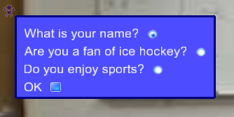

I attached the bmp file showing how the info box looks like. Each line of text is now left-aligned as we wanted but the problem is that the radio buttons are shifted as well.
Is there any way to have only the text aligned to the leftmost side and have the radio buttons aligned to the right?
