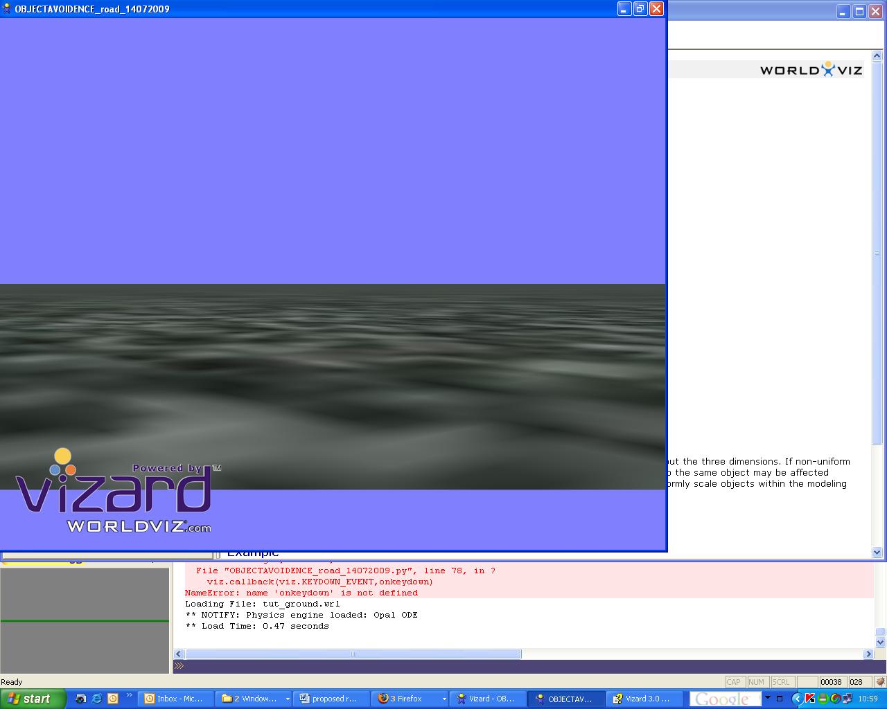

The screen looks like this- it's the blue strip at the bottom I don't want, it only appears when you start navigating forward and slightly left or right with the mouse and won't go away. I've realised I can get rid of the problem by resetting my setScale to 10,10,10. Although the ground doesn't really look how I want it too then. Is there any reason for this?
Many thanks.
J

OK, I see now. It looks like a clip plane issue caused by the large scale being applied to your model. Try manually specifying the clip plane:
viz.clip(0.1,200)
This sets a small near clip plane. Basically everthing between 0.1 and 200 meters from the viewpoint will be rendered.

That has solved the problem. Thank you.
J
