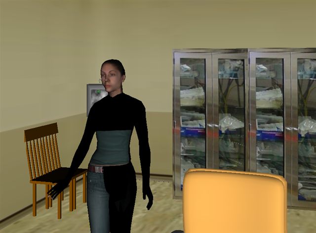

executable file with avatars incorrectly displayed
I have rendered an executable file of my script, which I need for a psychological experiment. My problem is, that the avatars in the script are displayed incorrectly (see attachement) when I run the file on a desktop which doesn't have Vizard installed. However running the executable on any laptop or on desktops with Vizard installed, resolves the problem. How can I get the file working on desktops without Vizard installed?
ID:	277   Click image for larger version

The executable runs independently, so having or not having Vizard on that machine will not make a difference. This sounds like an issue with the graphics card in that desktop. What kind is in there?

Hi Jeff,
Yeah I thought of a graphics card problem, too, but somethings bizarre:
I tried the file on different desktops (4 or more) and all of them didn't display the avatar correctly. Is it possible that they all have an insufficiently powerful graphics card?
For example: I've got a DELL Optiplex GX620, this is my computer at work and the graphics card is the default one - I don't know the name, though.
