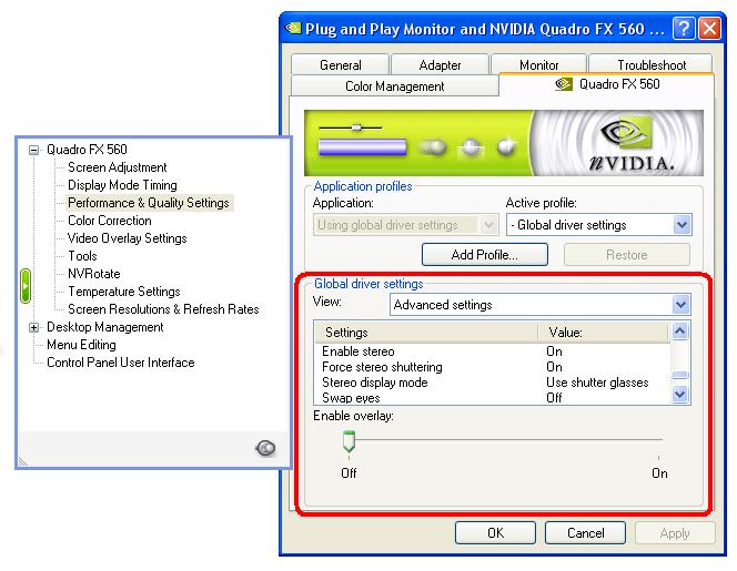

Are you enabling quad buffer in Vizard by using the viz.QUAD_BUFFER flag?
viz.go(viz.QUAD_BUFFER)
Also, you need to enable stereo in your graphics card settings. I've attached a screenshot showing which settings you need to enable.

Yes, quad buffer is enabled through the Vizard and stereo is enabled with the graphics card's settings similar to the image attached. During the simulation I can see left/right flickering image which I guess represents that graphics card is working.
However same flickering image appears on both Emagin screens instead of appearing on separate screens to provide depth. I have kind of tried all possible settings but still not successful. I wonder if there’re settings with Emagin that needs to be played with?
