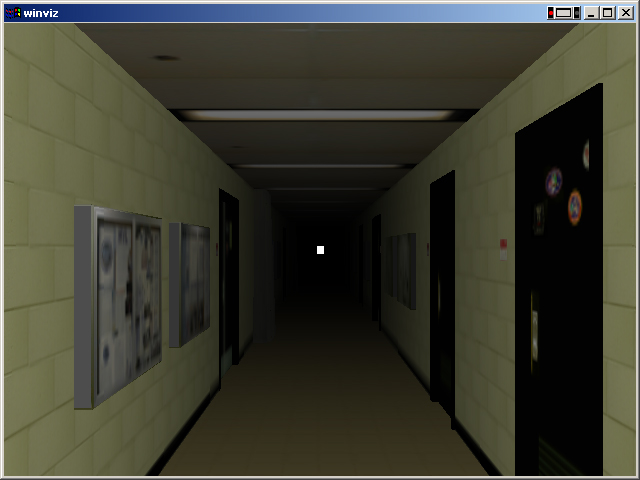

Under v2.12, when calling:
viz.clearcolor(1.0, 1.0, 1.0)
viz.fog(0.2)
I get a white background, but black fog? See attached file.
Old 11-20-2003, 10:45 AM
To set the color of fog use the following command:
viz.fogcolor(1.0,1.0,1.0)
