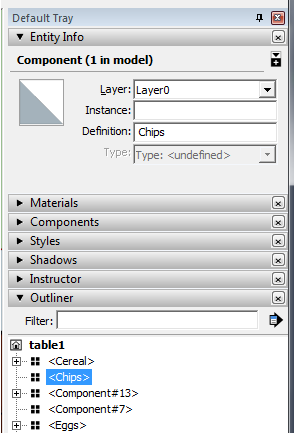

We created a model in sketchup, we are setting the name of models in sketchup in entity info tray, Definition field. We exported the model as dae, but when we import it in Vizard inspector, elements appear without names. Is it possible to export the name of elements and access it in Vizard?

It's possible to run a simple Vizard script that converts the instance numbers to the original SketchUp names. See the SketchUp to Vizard tutorial for more information.
