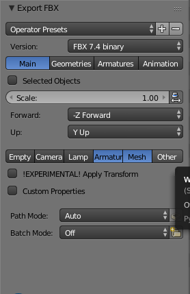

So, I created a 3D model of hand using blender, made a rig and exported it as an fbx format file.

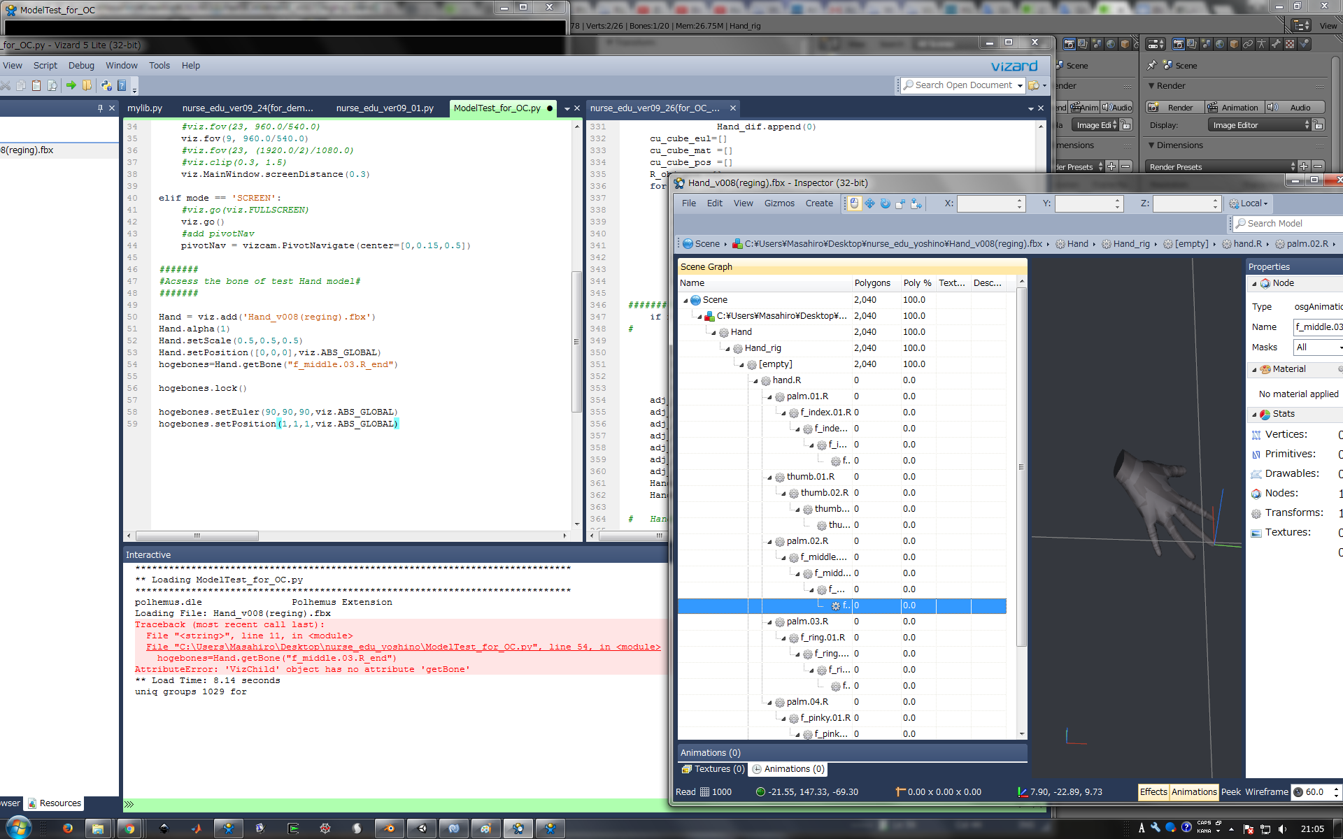

However, there are some empty nodes in the inspector on Vizard, and an error occurs when getBone.
(AttributeError: 'VizChild' object has no attribute 'getBone')
Please let me know the solution.

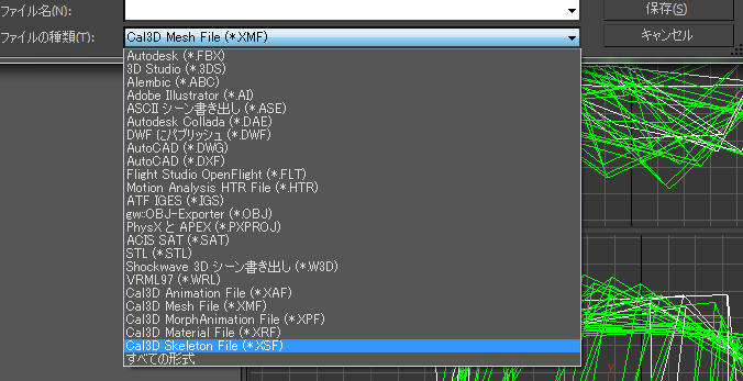

Which extension should I choose?
I tried export as XAF, MXF XOF,XRF,XAF.But Vizard cannot read these files.
Do I need to set something when exporting?
