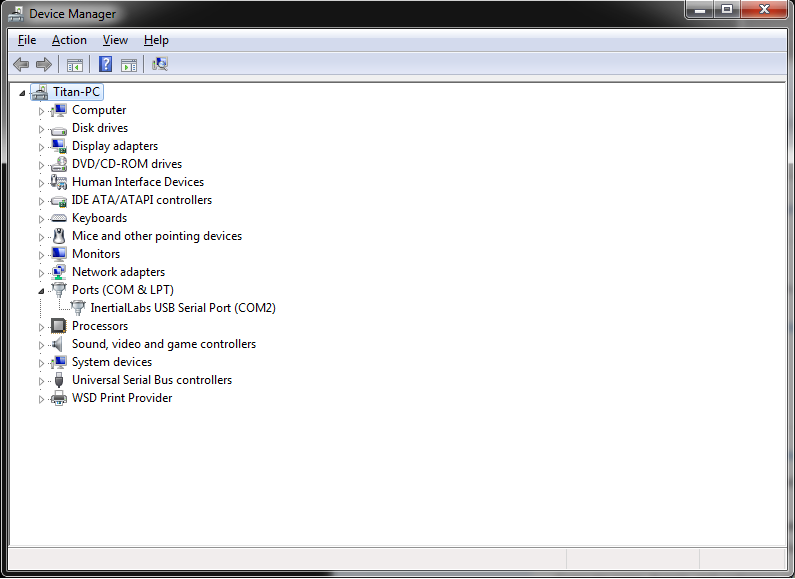

Also can you attach a screen shot about your device manager and point out where the Inertial Labs sensor is if possible?

Back on this again as I have a trade show in 3 weeks where I'd like to be able to use Vizard with the Inertial Labs sensor.
Sensor bus version doesn't work. Probably because I don't have a sensor bus.
I've attached my device manager screen shot. Shows on COM 2 as expected.
I'm running the latest Vizard 5 32 bit.
