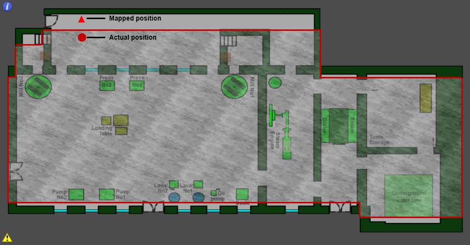

I have the following problem and was wondering if there is a solution. I want to use a scaled version of a top-down map, and have all position data transformed to the scaled map. A visual representation is included in an image. The gray/green map is the scaled version of the actual 3D space, which is superimposed with transparency (delineated also with a red line).
The map has a scale factor of [1,1,1.2]. How can every position passed to the map be automatically transformed to correspond to the correct spot? I use preScale but probably in the wrong way, as it scales the original 3d node, too.
I would appreciate if there is a way that does not involve multiplying every single value passed with a factor, as this would entail a considerable amount of tweaking.
Thanks!

Take a look at the onTheFly.py tutorial script (File > Quick Open > type: onTheFly). That shows a top down map of the scene and draws the position of the viewpoint in the map.

Thanks Jeff. I've seen this while trying to find a solution. However, it's an 1:1 scaling of the actual virtual world. If you notice the attached image, I want to have a different vertical scaling, translating all position data to reflect this change.
Is there a way to do this?

The onTheFly example script gets the view position of the bird's eye window in pixel coordinates. Those x,y,z pixel values can be multiplied by any scale factor when drawing the vertices that represent the view path. Are you also adding a bird's eye sub-window in your application?

I am using a bird's eye sub-window indeed. I followed your solution of multiplying each x,y,z position value that appears on the map with the scale factor. I was just asking if there is a more "automated" way to make this work, instead of having to apply the factor on every call of things (quads) appearing on the map. Probably not?
Old 09-16-2015, 02:45 PM
You could try applying a scale factor to the on-the-fly node instead of each vertex that's added.
