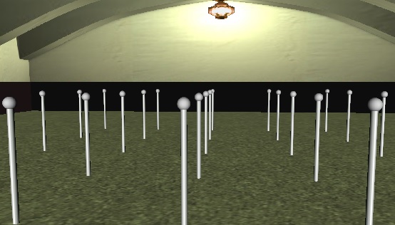

I am an absolute beginner user of Vizard Software. I am trying to run an experiment script in Vizard 5.1 (32 bit) and I found that some of the models (objects appearing on the scene) are either not appearing or appearing too small, but if I run the same experiment in Vizard 4 32 bit it's all behaving normal. Can anyone please help me with this problem? I am attaching a screenshots of the experiment with this to give you all a better idea of what I am talking about. If you guys look at the Screenshots of Vizard 5 experiment then you could see that objects are either not appearing or appearing too small compared to Vizard 4. I would greatly appreciate any help you can give me in working this problem.

Are these collada models? If so, take a look at the section about collada models being automatically scaled in the Vizard 5 upgrade guide.

Apologies for the delay in coming back you. Yes, they were collada models and your suggestion helped me to fix the issue. Many Thanks for your help, You are star!
