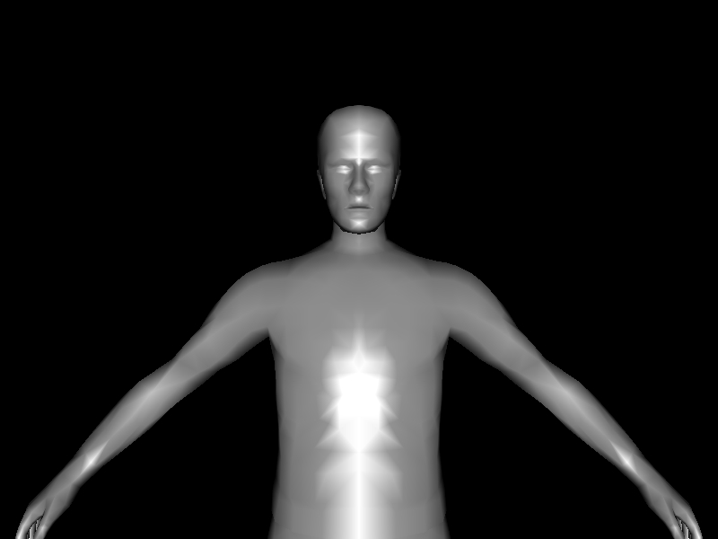

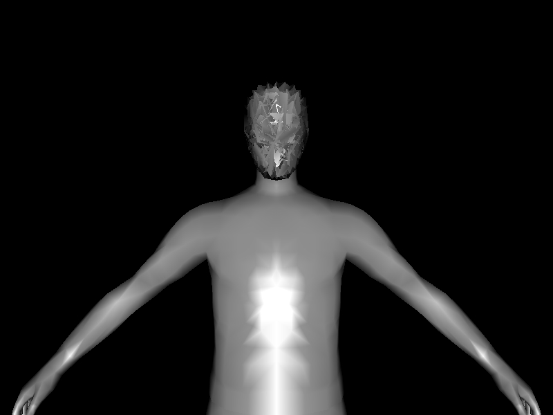

Hi all,
I am working with the Vizard Complete Characters library and I would like to import into vizard an avatar with a painful facial expression. I modeled this expression in 3DS max and exported it following the instructions of the CAL3D tutorial but I had the strange results you see in the attached screenshots.
Furthermore vizard sends me this error:
Loading File: casual02_m_highpoly_Expressions/casual02_m_highpoly_painful.cfg
** WARNING: Failed to load animation file: male_high_pain.CAF
Warning: Material::setShininess() of 6400 is above permitted maximum, clampping to 128.
** Load Time: 0.12 seconds
Could you please tell me where is the error?

Old 07-01-2014, 01:28 PM
Make sure the number of vertices in the morph mesh matches the number of vertices in the base mesh. Also the materials need to have "[number]" at the end of their names in Max. This is explained at the beginning of the of the exporting section in part 4:
http://download.gna.org/cal3d/docume.../tutorial.html
I'll put together a small knowledge base article in the next few days with some guidelines for setting up and exporting the morph targets.

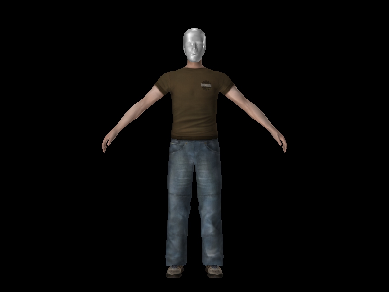

Dear Jeff
Excuse me for resuming this post after so long, but I am still having some problems in getting the entire exporting process correct, particularly in the material files loading.
I have attached the result of my modified avatar when I load it in vizard. The texture of the face still doesn't show (everything else works fine: equal number of vertices, bones, animations and morphs).
Here's the sequence of steps that I make when I export materials:
1-I open the material editor in 3ds MAX and rename the body texture as "body[0]" and the hair_transparent as "hair_transparent[1]"
2-I open the export command, choose .CRF format, name it "casual02_m_highpoly.CRF" and choose "body[0]" in step 1, and then "casual02_m_25.tga" in step 2
3- I make the same sequence for "casual02_m_highpoly01.CRF" and "hair_trasparent[1]", but this time I never find any .tga file in step 2
below is the .cfg file

Old 08-26-2014, 03:43 PM
Kevin Chiu Kevin Chiu is offline
Join Date: Feb 2012
Posts: 26
Hi Armo,
You will still need to choose "body[0]" when exporting both the "casual02_m_highpoly.CRF" and "casual02_m_highpoly01.CRF" hence the "hair_trasparent[1]" is not an existing tga texture.
Best,
Kevin
Old 08-28-2014, 11:57 AM
armo armo is offline
Join Date: Mar 2014
Posts: 21
Hi Kevin,
Thank you very much! now it works properly.
