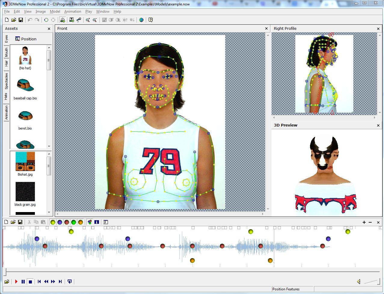

I would like to create a custom virtual head based on a front picture and a profile picture. I've tried to use 3dmenow for this, but as soon as I start the program, the example.now file results in a strange 3D preview. Looks like the photos are not correctly applied to the 3D model (see attachment). The same happens when I try to model a 3D head of my own head based on pictures. Somebody knows how to fix this problem?

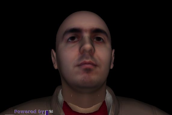

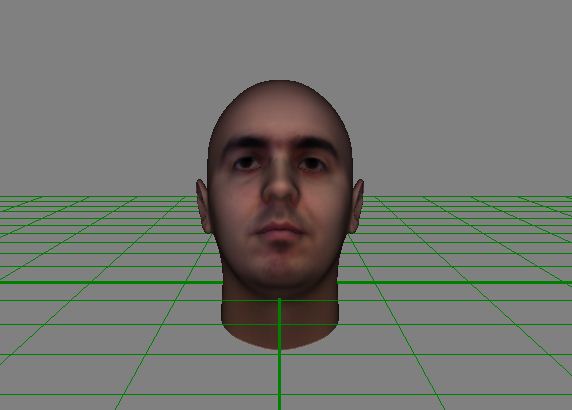

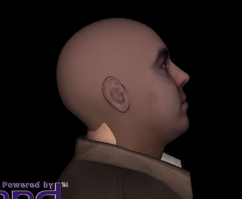

I'm going to use the regular Complete Character set, but for now I've use the male from the Complete Character set that comes with Vizard. The offset is already there in peoplemaker (after I've exported from facegen). The offset is about 20 degrees in pitch. If I change the pitch of the neckbone bij 20, I can make my face look straight ahead (which it should do in it's starting position). As you can see from the screenshots, my head looks about 20 degrees upwards.

It's not possible to make that adjustment in Peoplemaker. If you're not able to change the way the model is exported try and adjust the head in Vizard every frame:
vizact.onupdate(viz.PRIORITY_LINKS+1,morphing_face.setEuler,0,20,0,viz.REL_LOCAL)
Do you see any problem with the neck when you use this?
