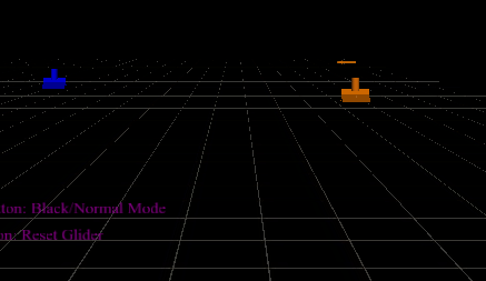

1. As the grid is just a texture on a quad I did
gridCoord= viz.add('../resources/joNew/gridLevel5.jpeg')
quad.texture(gridCoord)
quad.disable(viz.LIGHTING)
But it did not help (see attached picture).

1) I think it is an artifact of mipmapping, which causes the texture to become more blurry far away. See if disabling mipmapping will take care of the problem.
grid.appearance(viz.TEXNEAREST)
If this doesn't help then you might just need to make the grid a brighter color.
2) You are probably importing objects in the global scope of your module and importing the module before you call viz.go(). Remember that you can only add objects after viz.go() is called. So try importing your module after viz.go()

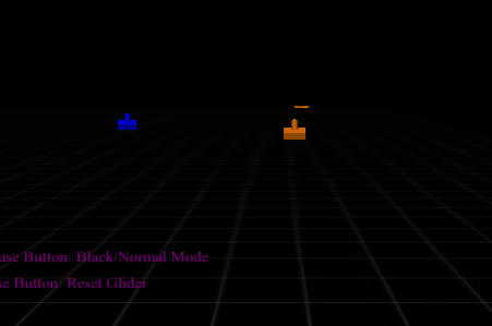

Problem 1 still persists also it improved (see attached). Making it brighter is difficult, as it is white. It looses the horizontal lines.

Old 09-02-2005, 04:11 PM

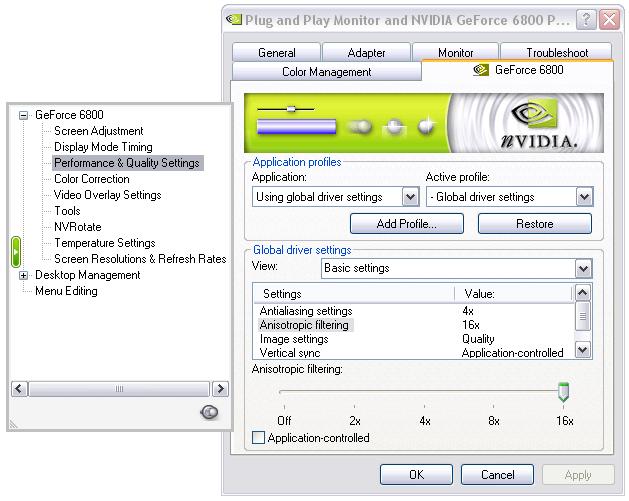

Instead of using viz.TEXNEAREST try something else. Go into your graphics card settings and turn on Anisotropic Filtering. I set it to 16x and it helped improve the image. I've attached a screenshot of how to change this setting using an nVidia card.

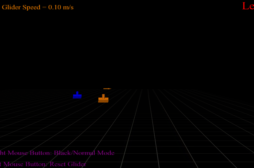

Thank you, that helped, the horizontal lines do not show great but that it is much better now than it was before.
I guess we can live with that.
I attached a screenshot.
