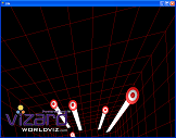

I've tried using the vizcave module to interpret this data, so as to avoid having to shift object positions manually, etc, etc. My first problem appears to be that I am initializing the cave wall wrong - I have captured the positions in FoB space of the corners of my monitor, and fed them into vizcave.Wall().
self.__cave = vizcave.Cave()
wall = vizcave.Wall(upperLeft  = (-.1585, .3409, .1739+.05),
                    upperRight = ( .1959, .3339, .1852+.05),
                    lowerLeft  = (-.2029, .0795, .1459+.05),
                    lowerRight = ( .2169, .0782, .1593+.05))
self.__cave.addWall(wall)
The '+.05' is because I measured to 5 cm away from my screen, to avoid magnetic irregularities. However, when I run this by itself, I get a slanted view out. However, it seems to me that it should start out looking straight ahead - I've done nothing else to rotate or change the field of view. I've corrected the FoB coordinate system to match with Vizard, but I'm guessing the little differences in the measurements were enough to torque the view? Is there any way around this, or am I feeding vizcave.Wall() all the wrong data?

Did you follow the single display example on the vizcave documentation page? What you are trying to accomplish seems very similar to that example. It sounds like you are not properly attaching the tracker to the viewpoint. Your cave setup code should look something like this:
cave.addWall(wall)
fobTracker = .... #Code that creates FOB tracker
# Automatically update the cave with the tracker
cave.setTracker(pos= fobTracker )
# CaveView object is used to manipulate viewpoint origin within cave
caveorigin = vizcave.CaveView(fobTracker)
You don't need to manually update the cave, the cave.setTracker command will do this for you. If your virtual viewpoint origin differs from the physical tracker origin, then you can use the caveorigin object to change it. The object behaves like a standard node objects so you can call setPosition, setEuler, etc...
The SPI module handles the projection matrices itself, so it won't work with vizcave. Also, vizcave is meant to work with projections on flat surfaces, so a curved surface like the Elumens dish will not be compatible with it.
