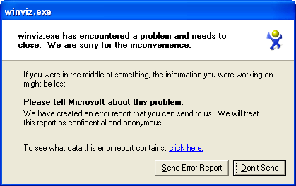

We have wired gloves from Immersion that we'd like to use within the newest version of Vizard. Unfortunately, when loading the cyberglove.dls plugin, winviz.exe crashes.
First I run the virtual hand device manager followed by the DCU. The DCU successfully shows the movement of my hand / fingers. Next when starting up a vizard demo, Winviz.exe crashes and supplies the error dialog boxes (see the bitmaps).

The second screenshot seems to suggest that the crash is occurring in the VirtualHand library. We have a wired CyberGlove connected over serial and it works fine. We are using the Aug 21 2006 build of the DCU. I really don't know what could be causing this. Do you have a minimal script that reproduces this crash?
