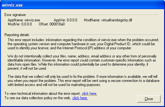

We have wired gloves from Immersion that we'd like to use within the newest version of Vizard. Unfortunately, when loading the cyberglove.dls plugin, winviz.exe crashes.
First I run the virtual hand device manager followed by the DCU. The DCU successfully shows the movement of my hand / fingers. Next when starting up a vizard demo, Winviz.exe crashes and supplies the error dialog boxes (see the bitmaps).
I just installed the newest version of Vizard today, as well as uninstalling and reinstalling the Virtual Hand SDK.
I did have some problems with the SDK working initially, however. I had an issue getting the authorization utility to work. The utility issued the following error: Init Failure: NETWORK: REPLY FROM NETWORK DRIVER IS BAD (-103) for C:\....\LICENSE.TXT. In order to fix this issue, I had to delete the c:\windows\system32\esnecil.ind file and re-booted my machine. I am wondering if this would have anything to do with Winviz.exe crashing.
Please help! Thanks.
