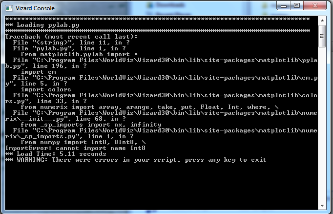

ptjt255 06-03-2010 03:25 AM
Error Message
1 Attachment(s)
Attached is the error I get when I run the pylab source file in case this helps.
Many thanks,
Catherine.
Attachment 373
Gladsomebeast 06-03-2010 10:58 AM
Just a guess, but try re-installing numpy as a module in that package is not right according to the screenshot you posted.
