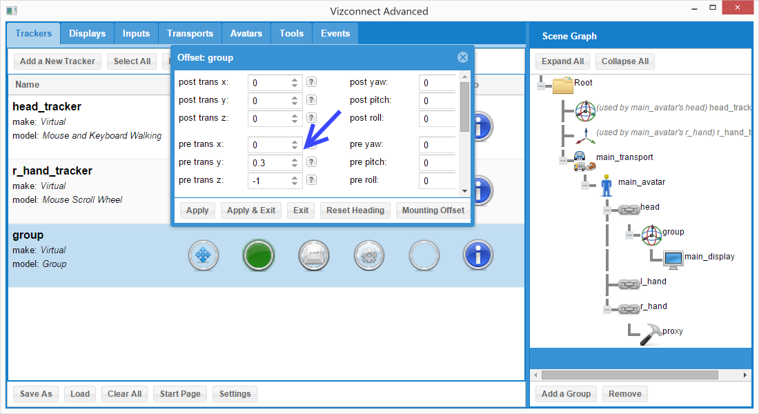

Jeff 07-28-2017 12:54 AM
1 Attachment(s)
Try adding a group tracker and placing that between the avatar head slot and the display in the vizconnect scenegraph. Then open up the offsets dialog for the group tracker and apply preTrans Y and Z offsets to move the display above and behind the avatar:
http://forum.worldviz.com/attachment...1&d=1501224830
rajnishv 07-28-2017 02:44 AM
Yes i did the same thing as u have replied,but was missing due to some offsets values for group tracker and now it works like a charm.
