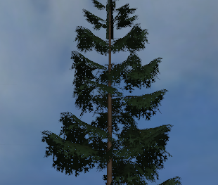

I am trying to make an animated tree. Right now if I export as osgb, the textures come out sharp pixel to pixel. This is what I want. But when exporting it with cal 3d as an avatar, the textures are blurred. This is a problem because I want my edges to be sharp but this is causing a blurry haze to appear around my textures.

http://forum.worldviz.com/attachment...1&d=1449441156 This is the weird effect I'm getting.

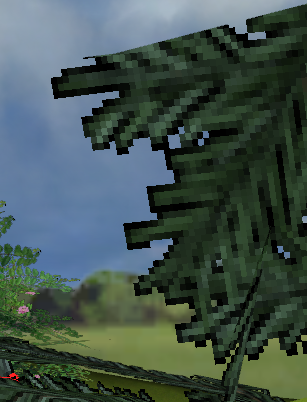

http://forum.worldviz.com/attachment...1&d=1449441164 close up

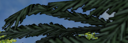

http://forum.worldviz.com/attachment...1&d=1449441169 this is the osgb that looks sharp.
Veleno 12-11-2015 02:33 PM
Hi lklab,
Unfortunately avatar materials do not currently support exporting unfiltered textures like you are using in your scene. You may be able to turn it on manually through code.
The checkerboard effect you are looking at is an artifact of multisampling alpha - a technique that prevents draw order artifacts. Normally this shouldn't be on in your model unless you've explicitly turned on GL_SAMPLE_ALPHA_TO_COVERAGE_ARB, but it's possible that it's being set by your graphics card.
