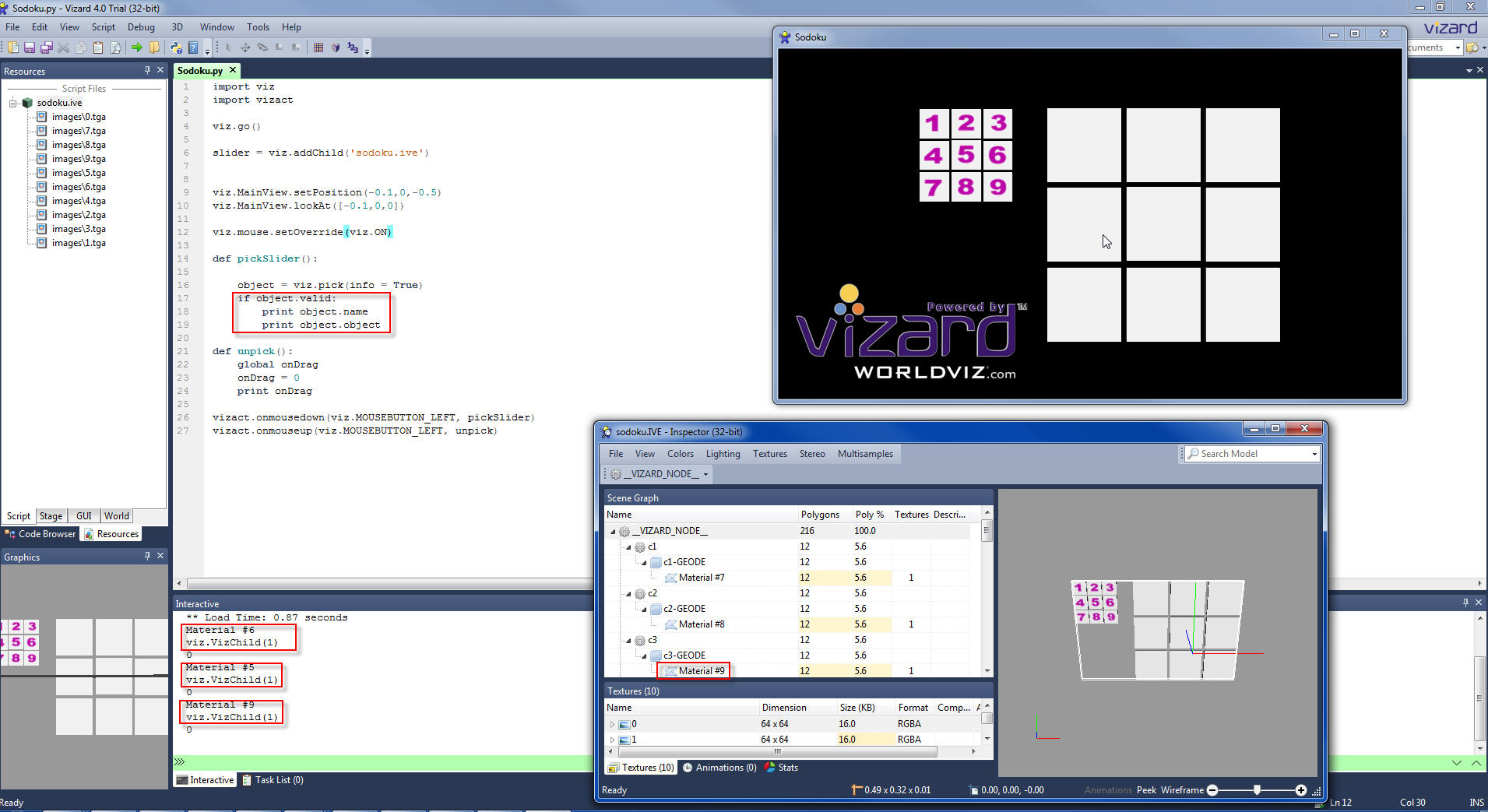

Hi all,
I'm very new with Vizard.
I'm trying to get object on mouse click. But I just get to root object viz.VizChild(1) not the subobject like c1,c2....
The viz.pick(info=True).name just return the name of material not object name.
How could I access to subobject?
http://forum.worldviz.com/attachment...1&d=1350637144
farshizzo 10-22-2012 04:21 PM
You can use the node.getChild command to get a handle to a sub-node. Example:
slider = viz.addChild('sodoku.ive')
c2 = slider.getChild('c2')
obj = viz.pick()
if obj == c2:
    print 'c2 picked'
Batigol 10-22-2012 08:30 PM
I already tried it. It worked.
