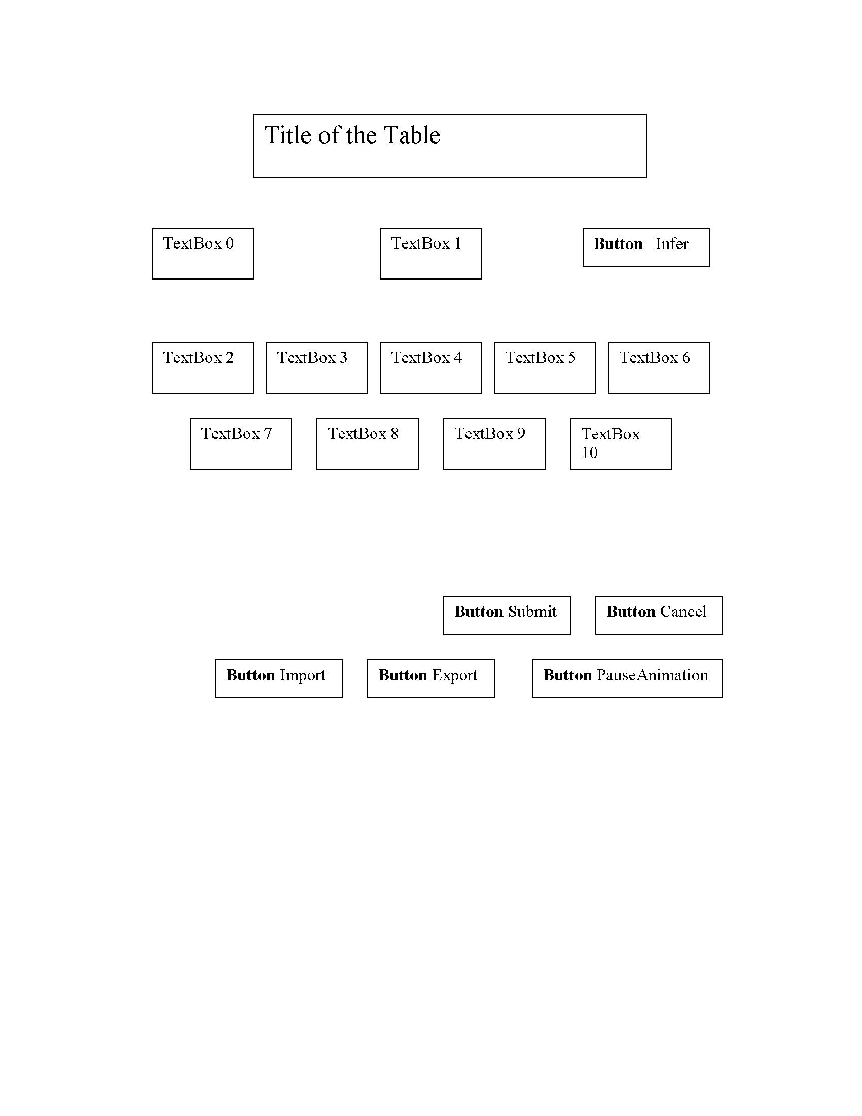

1 Attachment(s)
Attachment 237
Thanks for help. The table I want is like this one. In addition, if the table cannot be dragable and resizable, I just wanna put it on the left side of the screen. How can I do this? I think it's like manually set the position value. Could you please tell me the solution? Thank you.:rolleyes:
farshizzo 05-07-2008 09:55 AM
You can use the setPosition() command on your panel to place it on the left side of the screen. By default the panel is aligned to its upper left corner, so you can place it on the left side of the screen by using the following code:
panel.setPosition(10,500)
